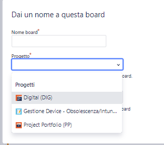

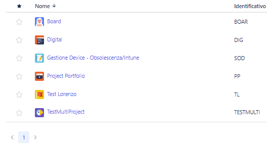

I am trying to create a single kanban board for multiple projects.
Problem encountered: I can't link all the projects present as per the screen below
1) All existing projects (attach 1)
2) Kanban creation (attach 2)
as you can see in the attach 2, only 3 project can be linked inside the new Board.
Is there any setting needed to update on the other projects?
I'm the admin of all the projects you can find in attach 1
thanks for your help
Lorenzo

John Funk
February 26, 2024
Hi Lorenzo,
Don't get confused that projects not showing in the Location field for the board means that the projects cannot be "linked". By linked I assume you mean that you want issues from those projects to appear on the board. That is based on the filter the board uses, not the Location field.
So, if you create a board filter like: Project in (ABC, DEF, 334, 123) then issues from all of those projects will show on the board regardless of whether those projects show in the Location field.

Bryan Trummer
February 26, 2024
Hi Lorenzo,
You may want to verify that those projects that are not showing up are not Team Managed projects.
