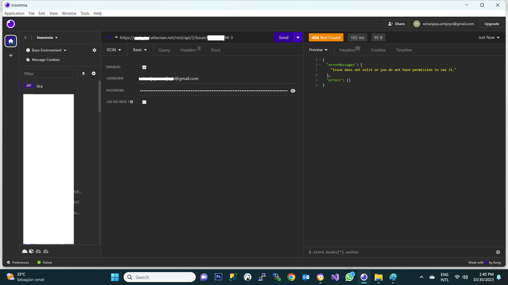

Hi,
I'm new to Jira, I'm trying to access Jira API by trying to get the issue info like below:
Header:
Bearer: API_TOKEN
it returns: (HTTP Status 404)
   "errorMessages": [
    "Issue does not exist or you do not have permission to see it."
   "errors": {}
I pretty sure the issue exists because I'm the one who created it manually, but I don't understand what does the permission mean?, I have used correct the API TOKEN.
any body can advice?
many thanks in advance

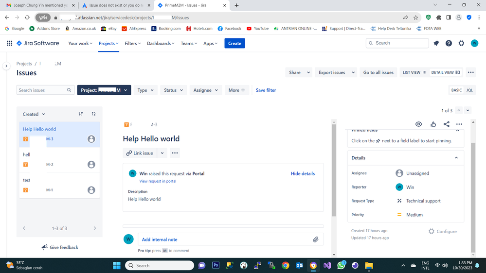

Win
October 29, 2023
@Joseph Chung Yin
Thank you so much for your reply, I saw there are 3 tickets (see enclosed screenshot), and we only have 1 project as of now.
I'm stuck and don't know what to do, need advice from the expert.
thank you so much in advance.
