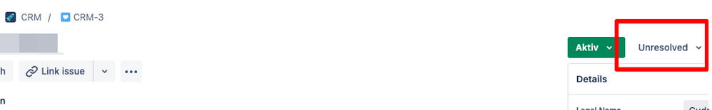

Your screenshot shows the green status with "unresolved" next to it as the resolution.  So someone has resolved the issue by selecting a resolution.
If the issue was unresolved, then there would not be anything showing to the right of the status.
An inexperienced administrator has added a resolution called "unresolved" to your system, and probably put it on some create or edit screens.

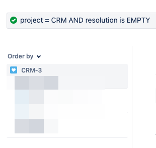

Christof Hurst
October 15, 2022

In a company managed project, the resolution does not show "unresolved" when the resolution is empty.  There is nothing shown at all.
The issue in your screen shot has a resolution set.

Again, the resolution is not set! Look at the issue navigator results.

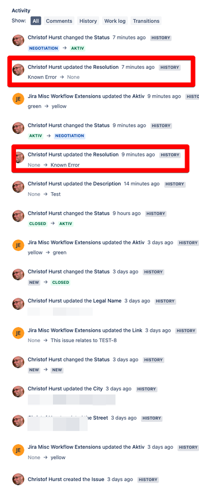

As expected, nothing changed.
The issue is still without resolution.
I also explicitly set resolution and cleared it but nothing changed. Either it's a bug or actually the status category done is displayed with strikethrough.[CRM-3] - cf Atlas Consulting 2022-10-15 18-13-55.pngIssue navigator - cf Atlas Consulting 2022-10-15 18-15-57.pngView Resolutions - cf Atlas Consulting 2022-10-15 18-14-41.png
Like Dave LIAO likes this

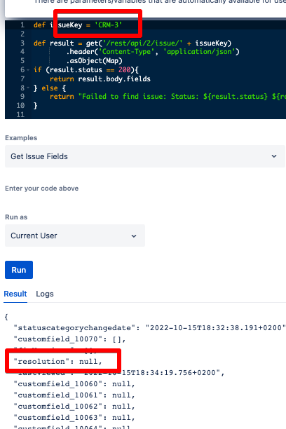

Christof Hurst
October 15, 2022

It's nothing to do with the status category.  The code doesn't even look at the status when it's looking to see if an issue is resolved or not.
Your screenshot clearly shows a resolution is set on the issue, and that's why you are seeing it struck out.

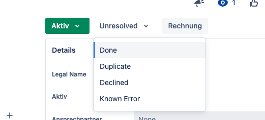

Could you do us another screenshot, same as the Aktiv / unresolved / rechung one you did before, but when the issue is in another status and there is no strikeout?
Christof Hurst
October 16, 2022
The screenshot shoes clearly that no resolution is set. Because there is no green hook, the history shows change to „none“, etc.

Sorry, but no.  The screenshot that has Aktiv / Unresolved / Rechung is 100% clear - there is a resolution set on that issue.
I can indeed reproduce this on my Cloud systems, in both team-managed and company-managed projects.
But to do it, I have to add a resolution named "Unresolved" and set it on the issue.  The status, the status category, all the other things that might feed into "done" have no effect.  I have to set a resolution to get the display of it and the strikeout.

Resolution is not set (visible). Not in issue, not in issue navigator, not in groovy REST call result. It is not set. Definitely.
Both System has no resolution "Unresolved" nor "None". The issue has no resolution.

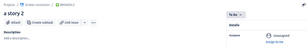

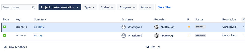

  • and then clicking through to one of them

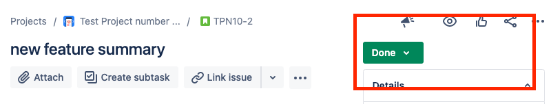

  • res2.pngNote the lack of anything to the right of the status - the issue is unresolved because there is nothing there.

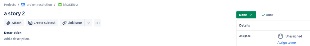

  • Close issue, and we see resolution set automatically (the default workflow does it)
  • However, also note that the resolution there has no drop-down option (hovering over it gives a tool-tip saying that the resolution cannot be edited)

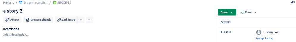

Keep it simple. I just made a new workflow with two statuses, Open and Done. One transition to Done and one back to open. No postfunctions, automations or any other adjustments. No automations.
Then two tasks in a project, linked together. One closed -> will be shown stroke through in the other. No resolution set. Check in Issue Navigator and in groovy REST call.
Forget about the dropdown. The wording "Unresolved" for null value confuses. A set resolution is marked with a green checkmark. So my screenshot showed a not resolved issue. It was just for testing. When setting to "Known error" that was marked green. Reset to Unresolved is not possible via the dropdown. Must be done via Postfunction. As shown in the screenshot, Resolution changed from "None" to "Known error" and back to "None". So resolution is defintely not set and empty,
Christof Hurst
October 17, 2022
Please make a test with
  • Issue in Done status
  • but no Resolution
  • Resolution field available on the edit and view Screen
You will see a dropdown right beside the green status with 'value' Unresolved but no green Checkmark. That means, that the field has no value but you can choose one.

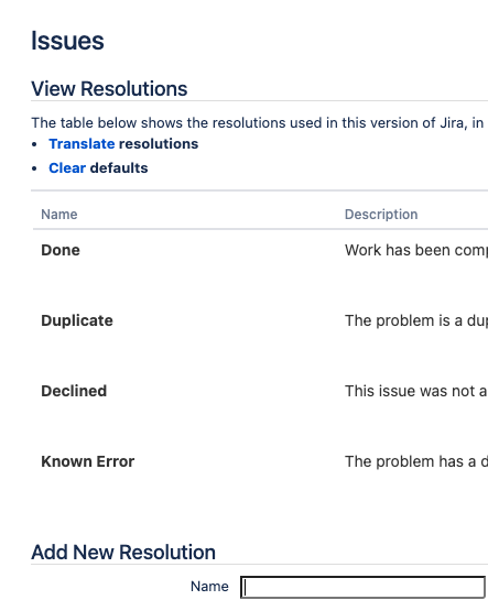

So, the next test I'd want to try on your system is to go to Admin -> Issues -> Resolutions, and change the default from "unresolved" to "known error" (I picked that as the least likely to look wrong to your people during that test), and try creating/editing an issue again.  What does a new/edited issue look like after you do that?

One last time: the issue has no resolution. Confimed via Groovy/REST, confirmed via Issue Navigators, confirmed via history. Additionally confirmed via removing the (non existing) resolution via postfunction. Defintely no resolution.
So it must be a bug. Or a feature to show issues with status category done stroke through. No other possibilities.

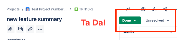

Trudy Claspill
October 17, 2022
@Christof Hurst
I was able to recreate what you are seeing. I am also using a Free subscription.

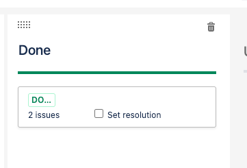

First, in my Board Settings > Columns, for the Statuses in the Done column I unchecked the box for setting the Resolution field.
In my case, I also did not have a screen attached to the Transition to Done that would let the user set the Resolution field.
When I then transitioned an issue to Done, the Resolution field remained empty.

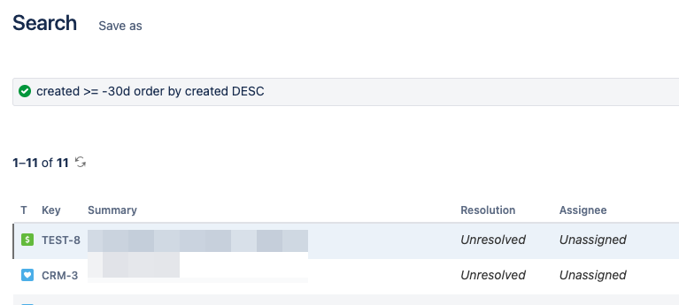

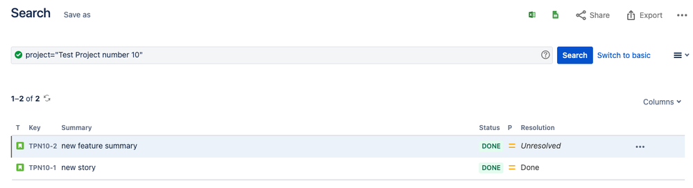

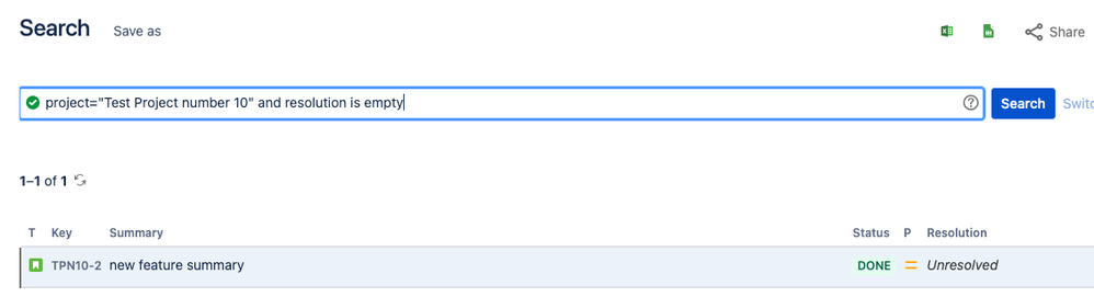

Notice the Resolution value shown in the search results is italicized. When the Resolution field has an actual value in it, the text is not italicized.
Screen Shot 2022-10-17 at 5.04.31 PM.pngScreen Shot 2022-10-17 at 5.04.52 PM.png

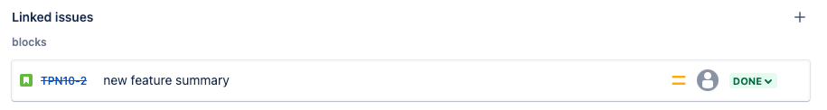

If I looked at that same issue under the Linked Issues list of another issue, then I saw the issue key struck through.
At this point I did not see Unresolved next to the issue's status...

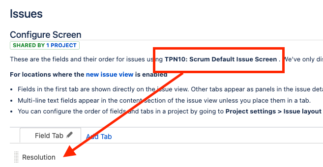

...HOWEVER I did manage to change that. By going to the Screen Scheme and adding the Resolution field to the View/Edit screen I was able to get "Unresolved" to display next to the Status, just like you see.

This is getting really weird.
I followed exactly what Trudy did and I still do not get an "unresolved" message next to the status.  I tried it on both a free and an enterprise install.
But the solution remains the same - don't put the resolution on the edit screen.  It should not be there.
Trudy Claspill
October 18, 2022
While I agree that having the Resolution field on the View/Edit screen is a bad practice, that is not actually a solution to the problem from the original poster.
The original question was how to prevent a strike through on the issue when it is in a status that is part of the Done status category but has an empty Resolution field.

Nic Brough -Adaptavist-
October 18, 2022
Yes, it's preventative, but the problem is that a resolution is being set because the field is on the screen.
Removing the field will stop it happening again, but the resolution set on existing issues needs to be removed too, and the solution to that is clearing the resolution by transitioning the issues to clear it out.
Christof Hurst
October 18, 2022
No, that's still NOT the solution because the resolution is NOT set. Despite if the field is on the view or edit screen. I agree that this is not common practice but it is not the reason for the problem.
Trudy (and I) put just a field on a screen to proof the field is unset. And it is. Putting a field on a screen does not change the values in an issue.
But the resolution is not set and was not set. The problem still is, that the issue is stroke through WITHOUT a resolution is set.
You did not get the "Unresolved" string because your resolution is set. Make an issue without  a resolution in a green status. Then you will get the "Unresolved" string IF you put the resolution field on view and edit screen.

Christof Hurst
October 15, 2022
What should a screenshot show? The issue is strike through and the resolution is not set...
Again, the resolution is NOT set!
All projects company managed.
[CRM-3] - cf Atlas Consulting 2022-10-15 12-04-40.pngList - Test Projekt - cf Atlas Consulting 2022-10-15 12-03-59.png

Hi @Christof Hurst
It appears that you are not using Jira Software in this site, but rather the features of Jira Work Management.  If that is correct, then you should be aware of this known issue JWMCLOUD-210
On Business projects (which have their own boards), the issues will be set to Done, but not have a resolution value set on them when this happens.  It is a known issue that seems to be affecting you here.  I'm afraid the other answers on this thread could apply, if you were using a company managed Jira Software project, as the boards and workflows in those project types rely upon different code there.
But there is a noted work-around on that bug ticket whereby you can setup an automation rule in order to automatically set the resolution field value when the issue reaches that specific Done transition.
I hope this helps.

You are also wrong. There is no and there was never a resolution named "unresolved". I'm not stupid. I know what I'm doing. Also the issue had never a resolution before
The resolution field is presented because I added it on the Screen to test. As soon as I select a resolution, it is still displayed but with a green hook in front. This means, a resolution is set. My screenshot just shows, that NO resolution is set. So it's unresolved and you are right as this means NULL (or None).
