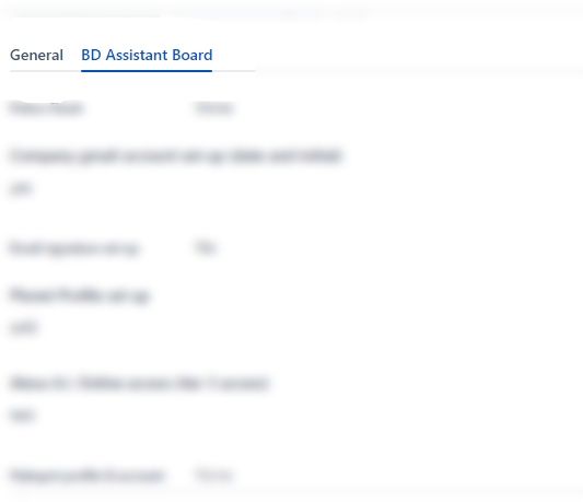

Hi,
I have created two custom tabs on Issue Configure Screen with different fields. When a ticket is created the tabs are shown on the View Issue Screen, but all the fields are shown on the "General tab" the other tab "BD Assistant Board" only has one field. I want each tab to have and show the fields that I have added on Issue Configure Screen. I have added some screenshot from Configure Screen and what I see as agent on View Issue Screen.  I would really appreciate your help.

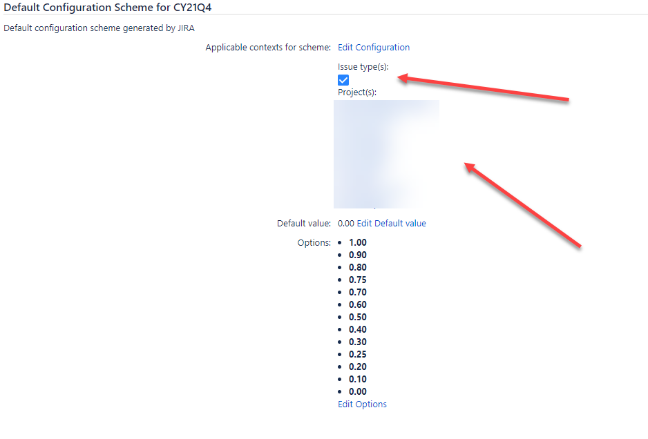

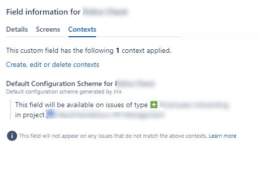

Welcome to the community.  You will need to work with your Jira/JSM administrators to access the custom fields configuration setup to ensure those missing fields (even you added to your project screens) are exposed to your project context.
From your project screen scheme, you will see all the fields during screen configuration, however, the actual fields may not be exposed to your project at the systems level.
As you can see from the above image, each custom field can be setup with context based on Issue type and projects.  If the field is not exposed to your projects, then even you were able to added to your projects screens, it will not show up when you access your issues in the project.
Hope this helps.
Best, Joseph Chung Yin

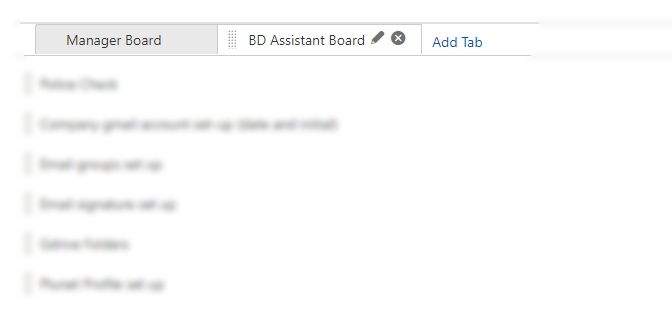

Ada Dedja
November 5, 2021
I have configured the fields on Issue Configure Screen on the BD Assistant Board (see attached I have to blur the image), but I haven't configured on the Manager Board ( shown as General on Agent View). Both Tabs have different fields configured and for the BD Assistant Board from all the configured fields is just showing one of them.
I have set-up just for one screen, the one that I am using for this type of request.
Thank you!

Ada Dedja
November 5, 2021
Correct! All the field are shown under “Manger Board/General” including the fields configured on Issue Configure Screen under “BD Assitant Board”.

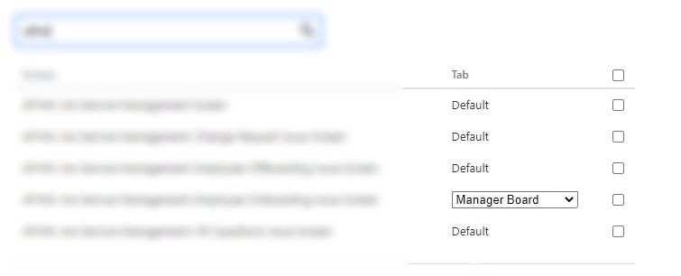

I was creating new custom fields today and noticed this when I was trying to associate the field to screens, the other custom fields were created  before I created the 2 tabs. Should I re-create them and associate them again to the tabs like it is shown on the attachment?
Thank you,
Ada
Joseph Chung Yin
November 8, 2021
From the image above, those custom fields are not attached to the screens associated with your project.
Did you have a separate screen configuration scheme for your project?  If yes, please re-associate those fields proper to the screens used by your project.
If you associated to the right screens for your project, then you will see the tab dropdown for them.
Best, Joseph

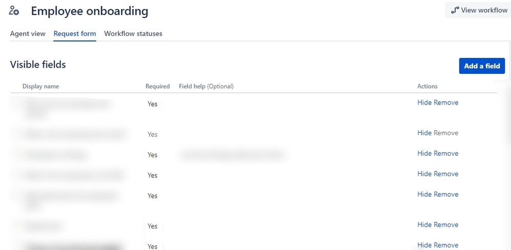

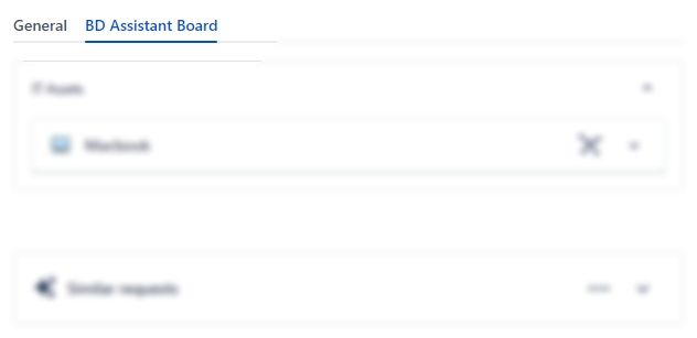

Ada Dedja
November 8, 2021
I found a solution for this issue, but it is not the optimal solution. So if I hide the associated fields with "BD Assistant Board" tab from Request Form (the portal) they will appear on "BD Assistant Board" tab on agent view.
What could be the possible reason that it is acting like that?
