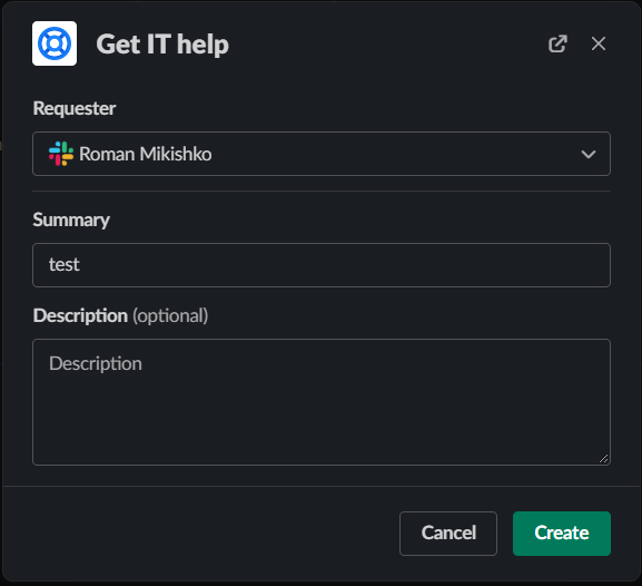

Perhaps you misunderstood me. When creating a request in Slack, we aren't able to select the Issue Type we want. The default Request Type is [System] Service request.

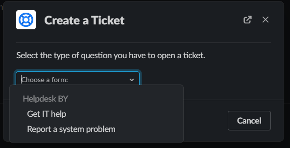

Your image seems to show that you can select one of two request types:
  • Get IT help
  • Report a system problem
As others have mentioned when creating a ticket you cannot select the issue type, only the request type. If you want the option to create an issue of a different type then I think you need to create a new Request Type which maps to the issue type you want.
I'm not familiar with setting a default request type so I don't even know if that's possible or not but if it is then once you create the new request type you would just set it as the default.
