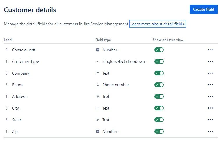

We have an external CRM which contains all our customer information. I would like to integrate our CRM with Jira Service Management so that we can assign Jira issues to our existing customers, being able to view a limited amount of customer data from the CRM when viewing a Jira issue.
In Jira Service Management, I'm able to define additional fields on a customer.
However, my customer list is thousands long and it's not practical to manually enter all this data or to manually maintain synchronization between systems. There is a CSV import option, but this is manual and I'm looking for a fully automated way to keep information up-to-date in Jira from my main CRM.

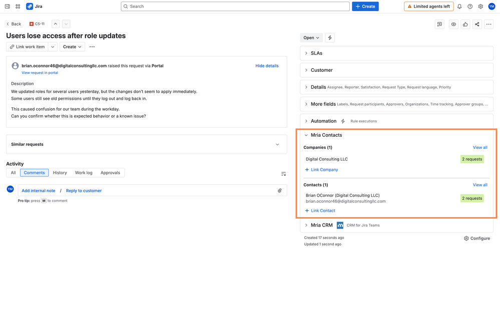

This is exactly the gap Mria Contacts: Contact Management in Jira & JSM was built to close: Jira and Jira Service Management do not provide a strong native layer for importing, managing, and surfacing structured customer and company data inside issues and requests.
Instead of relying only on native JSM customer fields, Mria Contacts adds a dedicated contact and company layer inside Jira/JSM.
For a case like yours, that means:

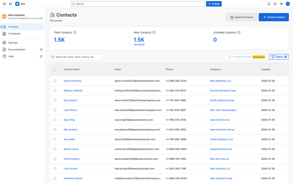

1. Bulk import instead of manual maintenance
You can import large volumes of customer data, so you do not have to create and maintain thousands of records by hand.
2. Structured customer records inside Jira
Contacts and Companies are managed as proper records, including relationships between them, rather than being scattered across custom fields.
3. Customer context in both Jira issues and JSM requests
The data is available directly where the team works, so you can use customer and company context in regular Jira issues as well as service requests.

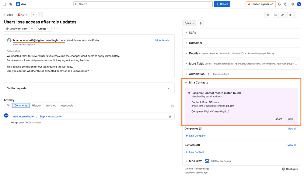

4. Automatic recognition in JSM
In Jira Service Management, the app can recognize the requester by email and suggest the matching Contact or Company, so agents can connect the request to the right customer context faster.
So if your goal is to bring customer data from your CRM into Jira/JSM, connect it to the right issues or requests, and make that context visible to the team in their workflow, that is exactly what Mria Contacts is designed for.
