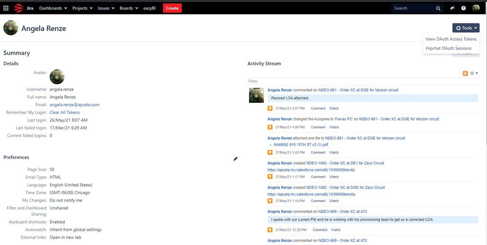

Thank you for getting back to me and so I did have a look at Manage your personal settings.  But it appears that I am not authorized or something.  When I go to my profile I don't even see where there is a link to change my settings.  See the shot below.  Could the admin have this option disabled so I am not allowed to do that?

Okay, you're on Server/DC. The logic that Jack and I mentioned above still applies. However, in this case, you can update the Autowatch field under Preferences. Here is the link for Server/DC installations: Managing your user profile.

Ok so I tried that - I will see if that works.  Thanks so much!
