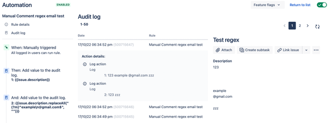

Currently the regex expressions in Automation are using Java pattern matching. So when trying out expressions is best to use one that you can select the Flavour of Java e.g. https://regex101.com/?flavor=java&flags=g. The reason ^ and $ aren't working is by default multiline is being turned off (you can simulate that in that regex link). So you need to use the manual way of turning it on which is putting (?m) at the start of the regex.
Similar with using dot matcher on new lines, you'll need to use specify (?s) to force the regex into that mode.
Example of using replaceAll to remove part of an email address from the issue description:
Hope that helps, you can also get in touch with support if you require further help with your rule.

Thank you, Yvan. That was the info I needed. I managed to get my regex to work.
