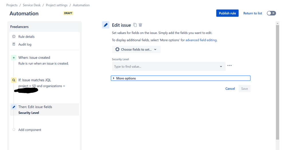

Hi @Mustafa Aydemir - You'll want to configure Issue Level Security.  Then you can use an automation rule like this:
  • TRIGGER: Issue Created
  • CONDITION: Customer = X
  • ACTION: Edit Issue (Security Level)
    • Your desired Security Level

Hi @Mark Segall
I have tried what you have told me but when I am trying to make the automation I can't choose "my desired Security level".

Did you follow all of the instructions in the link I provided in my last message?  You need to configure issue level security and then the security levels you configure will be available to the rule.  Also make sure the rule actor has the "Set Issue Level Security" permission in the permission scheme.

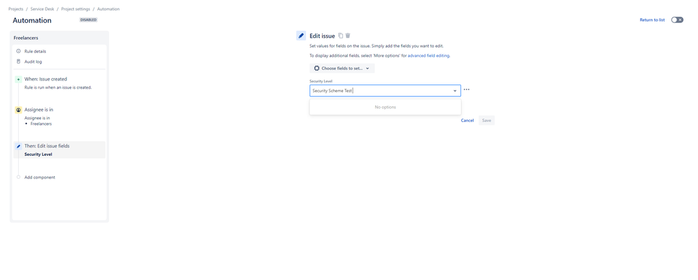

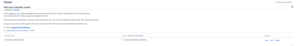

Hi @Mark Segall
I followed the instructions in the link you send earlier.
I have done all this. Check screenshot. I cannot enter the "scheme" I made in Issue Security.Skærmbillede 2023-06-22 130334.pngSkærmbillede 2023-06-22 130132.pngSkærmbillede 2023-06-22 130113.pngSkærmbillede 2023-06-22 130205.pngSkærmbillede 2023-06-22 130045.png

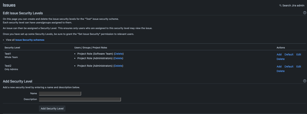

In your issue security scheme, you need to set up security levels.  The automation rule would need the appropriate security level.  Here are some sample security levels that I configured in my test environment:

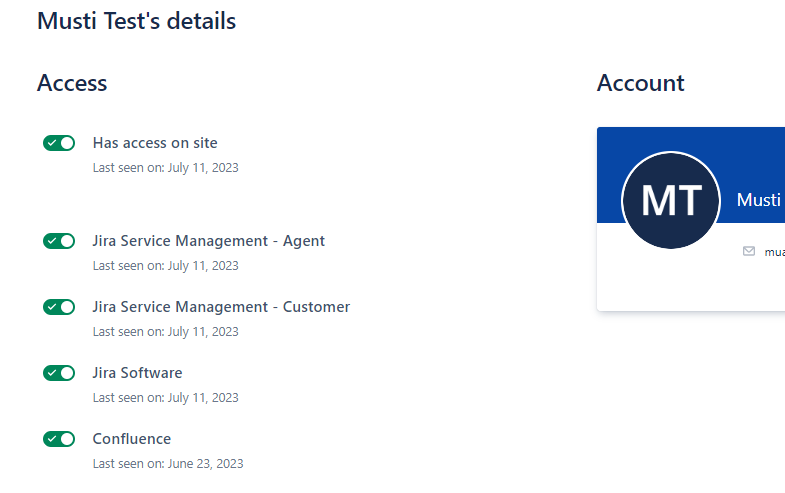

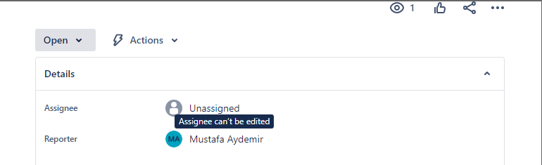

Hi @Mark Segall
The test account has all roles/groups enabled as you see here.
This is the error I get.

I believe that you also need to assign the test account to jira-servicemanagement-users-YOURINSTANCE. This provides licensing to the test account.  This group trumps any permissions you may be granting the user.

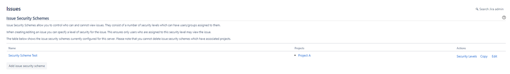

  2. If Yes to the previous step, have you configured the issue security scheme and associated security levels?  If so, please share a screenshot

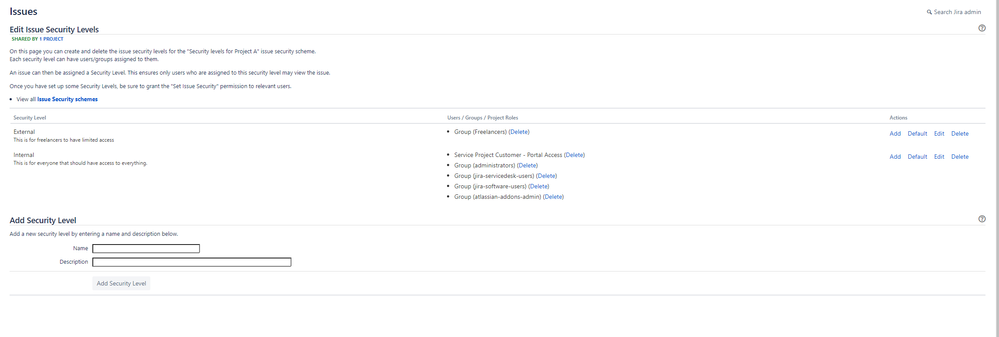

    - Yes. Here is the issue security scheme.

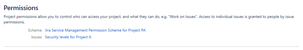

  3. Have you added Security Level to your issue screen?
    - Do you mean this when you ask for issue screen?
  4. If yes to the previous step, try creating a test issue and setting security level.  Are the configured security levels created in step 2 available for selection?
    - When i try to create a issue I can only choose "internal security levels" on my admin account. I know that if I add admin on external security levels it's possible to choose between external + internalSkærmbillede 2023-07-11 121543.png

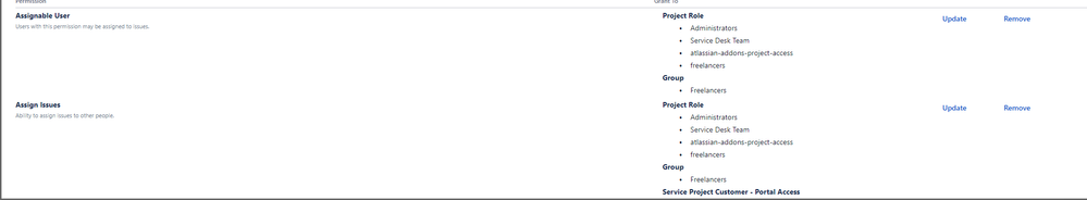

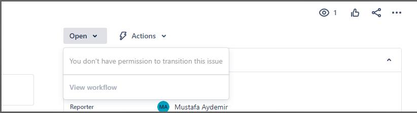

  5. If yes to the previous step, validate your security levels are working as expected on the test issue created in the previous step
    - I have given permission to freelancers to be assignable user + transition issues. but it is not possible to do that.
    Skærmbillede 2023-07-11 122034.pngSkærmbillede 2023-07-11 122108.pngSkærmbillede 2023-07-11 122204.png
