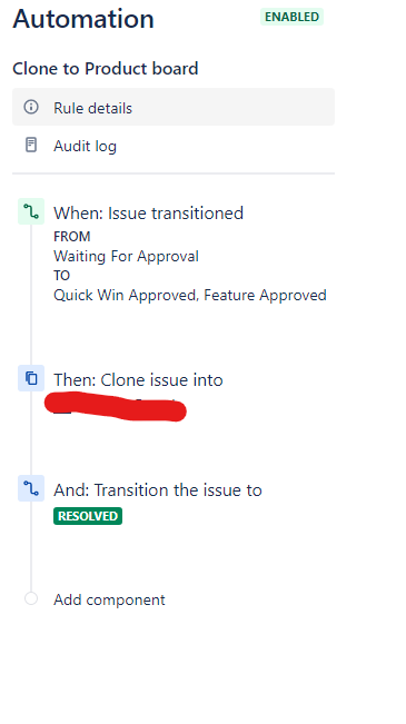

@Michael Andolfatto thank you for this, so I have been doing some digging on this and looking at the automation there is an option to clone the ticket.
As opposed to moving a ticket, is this correct?
The idea being once a ticket has transition to status X or status Y that ticket should "move" to the board.
I have attached what I came up with. Any thoughts or advise would be much appreciated.jira automation 2.png

Hi @Mihir Ruparelia ,
That should work, but I would recommend testing this with sample data first. It looks like the Move operation is not actually supported via Jira's automation, so the structure you have to resolve the original (or delete it) is what's recommended instead.
