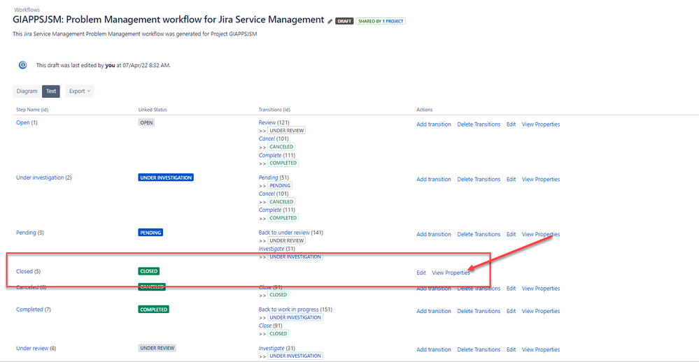

Here is what you need to do.  Access your JSM project's WF (one in question):
1) Project settings >> Workflows and edit the WF that you need to modify.
2) Once in the specific WF, click on "View Properties" associated with the terminal status. (Example - In this WF, "Closed" is the status)

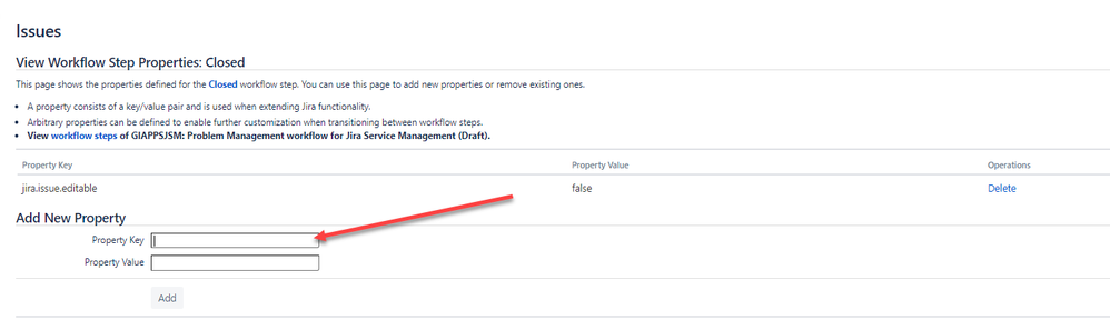

3) In the properties screen, just add in "jira.permission.comment.denied" and apply the change.
4) Lastly, remember to publish the WF to make the change into affect.
Here is a reference link from Atlassian regarding to workflow properties - https://support.atlassian.com/jira-cloud-administration/docs/use-workflow-properties/
Hope this helps.

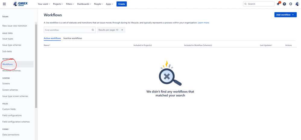

Your screenshots look like they're got to via:
Unfortunately none of the workflows for the built in issue types seem to appear here.

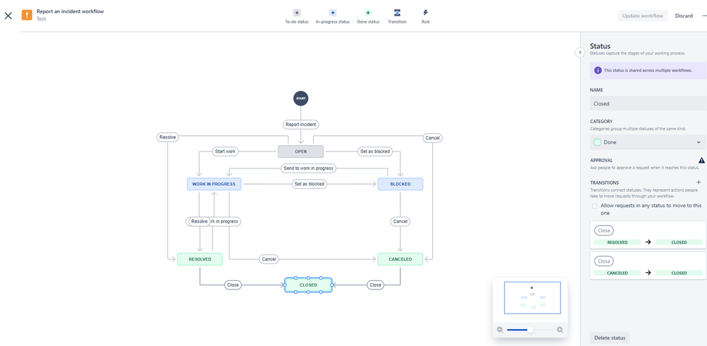

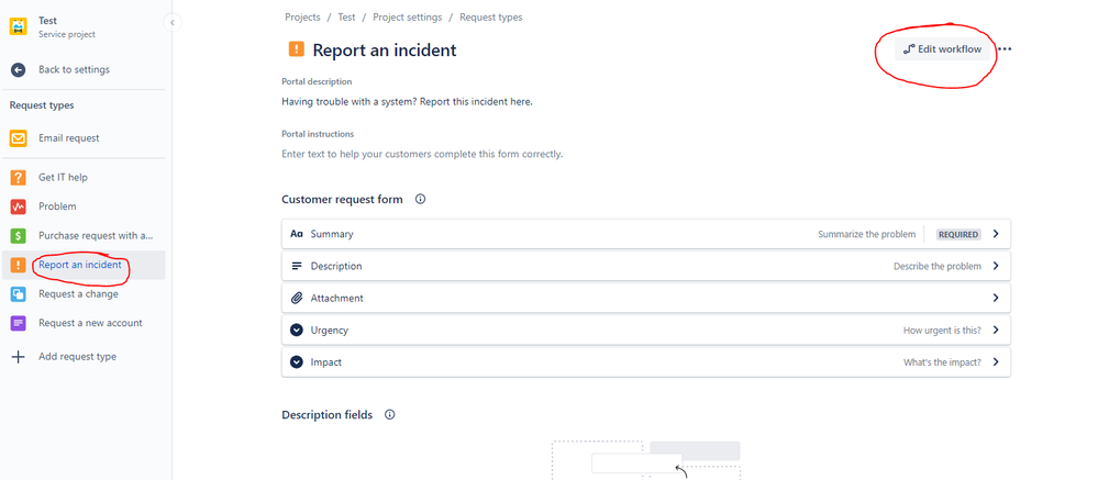

The only way I seem to be able to access them is through the project settings:
I can't see any way of adding a property to these in built issue types. Do you know whether there is a way?

Your JSM project "Test" is a Team Managed Project type based on your latest screenshot.  Therefore it is not possible to conduct this type of customization with "Team Managed" projects.  If the project is created using "Company Managed Project type", then it is possible.
The reason why you cannot locate the Test project's WF via from the System configuration UI (under issues >> workflows), it is because the WF in your Test project is 100% local because it is a "Team Managed" project.
