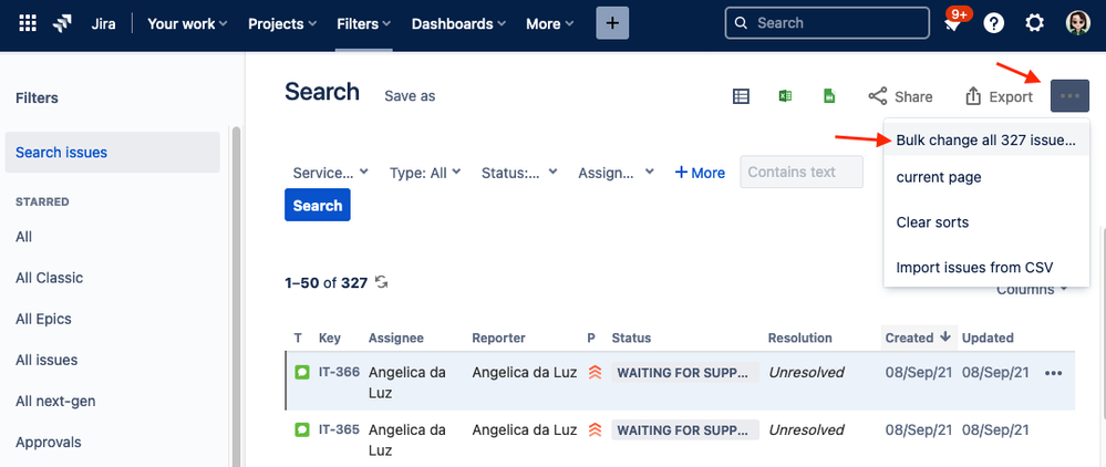

With this said, in case you didn’t, you need to create a brand new team-managed project with the desired template and after that, go to Issues > Advanced search and filter all the tickets from the company-managed project.
Then, on the top right, select … > Bulk change all X issues. On the next page, select all the issues (if there are more than 1000 issues, it will be necessary to move 1000 at a time) > Next > Move > Select the new project and the issue types > Next > Confirm.
