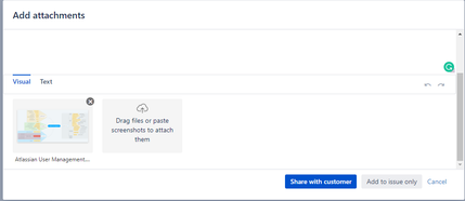

As an agent when uploading attachments in the issue screen, there is an option to share with the customer or add to issue:
2020-02-13 11_57_19-[SUP-14299] Assets with multiple Depr Books - UNOPS TEST JIRA.png
In an issue with multiple attachments, is there any way for the agents to know which attachments are shared with the requester and which are not after they have been uploaded?

You should be able to see attachments on the comment itself and and whether the comment is Internal or not.
Add to issue versus Share with Customer
  • Assuming you are editing a comment Add to issue means there will be no email notification to the customer.
  • Assuming you are editing a comment Share with Customer means the customer will receive an email notification letting them know you edited the comment.
One is always given a choice when adding an attachment as the agent... Share with customer (goes to the customer) or internal.
