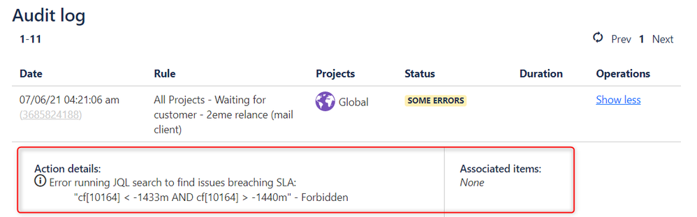

I have setup some automation rules using the SLA Breached trigger.
However I am prompted with random failure errors such as the below:
As you an see, this has not been triggered by an issue but is just erroring out on its own.

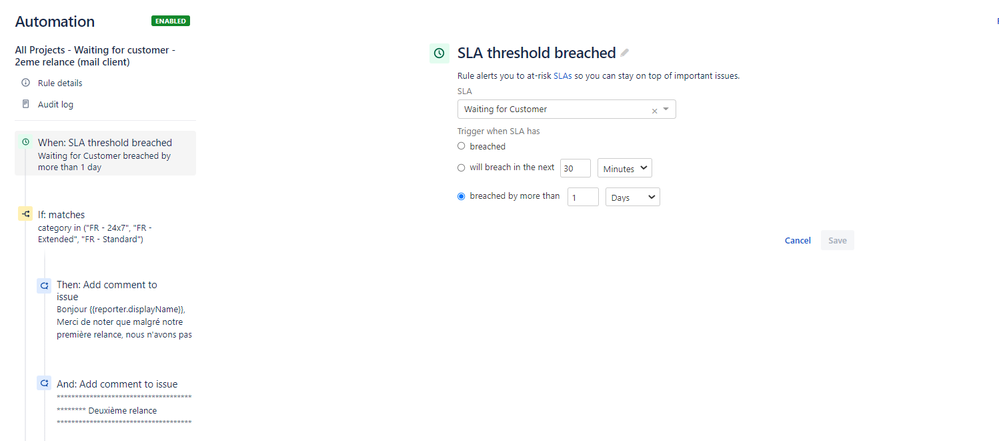

I solved the problem.
In the SLA configuration you must have at least one more JQL besides "All remaining items".
You can create a JQL per item type, for example. It can even have the same time target as the remaining items.

The error message is odd. And I wonder what your automation looks like. Could you share a screenshot? What I don’t understand in the error is you have a custom field that appears to be looking for a value that is less than 1433 minutes and at the same time greater than 1440 minutes which certainly doesn’t make sense.

The rule:
The custom field which is being checked is the "SLA - Waiting for Customer" which I have created to track the time spent in the "Waiting for Customer" status. It is not a custom field per say but a custom SLA.
The weird part is that this error is being triggered even though the SLA has not been breached. It seems like it's an auto-trigger of the filter itself; since the rule is running correctly for any ticket for which this SLA is breached.

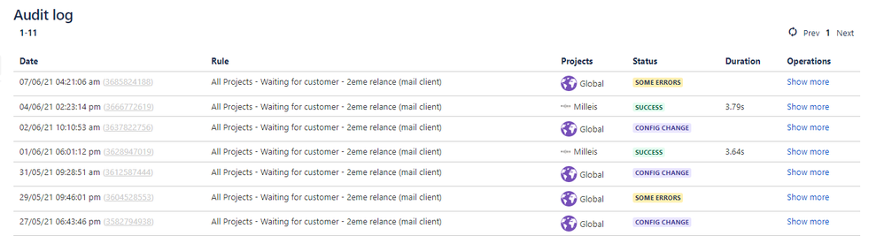

And sometimes for another rule using the same SLA, I'm getting the below error messages and it's very intermittent:

Is there some sort of automatic verification of filter on Atlassian side? I am asking since it seems that the system has ran this filter randomly and hence this error message
