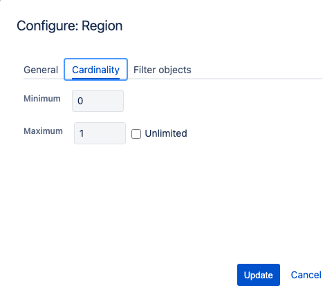

Hello @Danielle David , if I understand correctly, you want to do a one to many relationship (e.g. 1 employee to multiple laptops).
This is possible. For the attribute in question, click on the settings cog icon, then select cardinality, then select the maximum number of objects that be selected or "unlimited", then select update (as shown below for the Region field).
Hope this helps!
