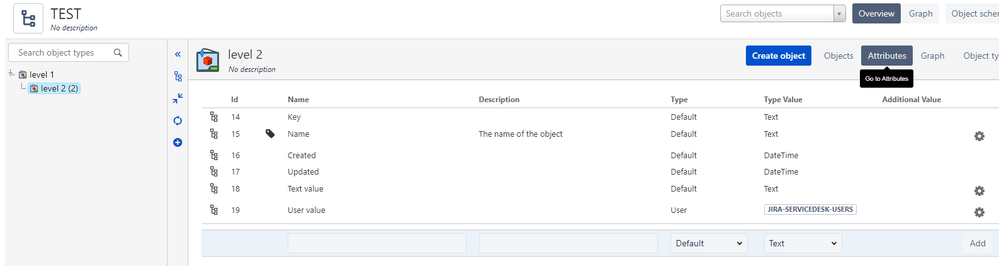

I just set up a  simple test object schema with 2 levels.
Level 1: Abstract and inheritance on with 2 attributes (Text and User)
Level 2: Child of level 1

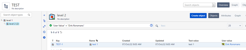

I added an object on level 2 with a value in the User type attribute and when I do a query it works fine..
I've also tried it with the id of the user and that works as well.

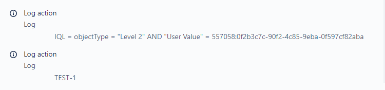

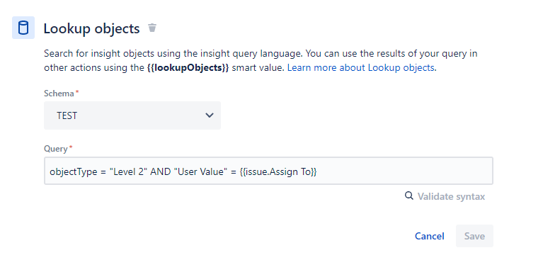

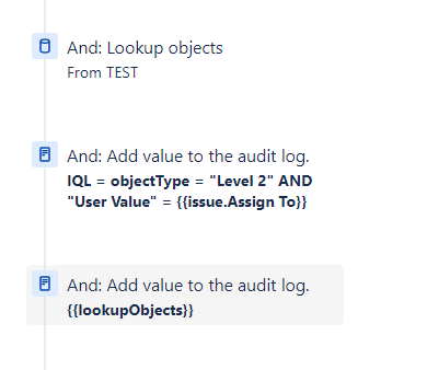

So i'm not sure if I set it up differently from you or what is going on but for me it works.
I set up an automation rule (manual) that does the IQL for a lookupObjects and it returns the correct value.
I threw a user picker (single) field on an issue type and used that in the IQL.
These are my steps in my test:
and my result:
So if you are stuck still with some issues I think we need more detailed info.
