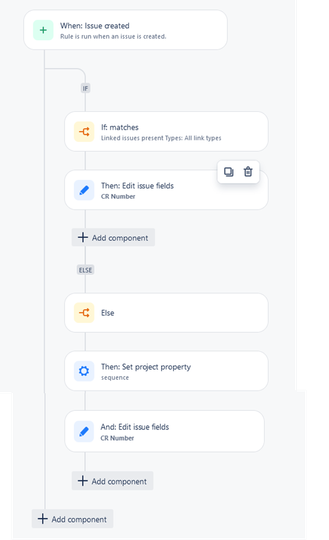

I want to increment a custom field when an issue is created, but I don't want it to increment if the issue is created by cloning; it should remain the same as the main issue.
I've attempted to create an automation for this purpose, but it's not functioning as intended. I'm open to any suggestions on how to improve it.
Please find the automation rule:
The 'Edit Issue' block in the 'if' and 'else' conditions are the same:

Is Clone check working correctly? That is, issue CR Number is being edited?
If only the increment logic is not working, Have you tried to increment the entity property manually, that is giving below smart value:
{{#=}} {{project.properties.sequence}} + 1 {{/}}
Please try and also share audit log of a run and share which logic was supposed to be invoked (cloned/or not).

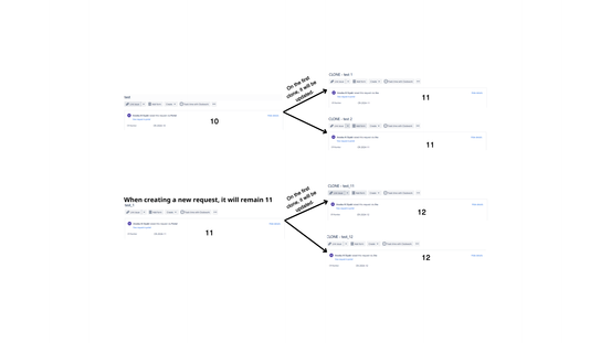

The problem occurs when I first create a request; the CR number is not updated. It will be updated when I clone the request for the first time. If I create another request, it will remain the same.
Please finds an example:
