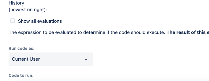

Just to check, are you setting this listener to run as the current user, or as the ScriptRunner Add-on user, in this field:

running it as "Current user" does indeed solve the problem, thanks!

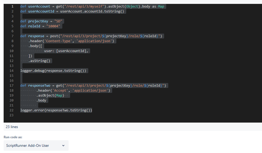

From what I can see the only way I can find to add the user to the roles would be programmatically. You can get the ScriptRunner Add-on user account Id using the "Myself" REST API while running the script.
I have written a short example, you can find this here: https://bitbucket.org/Adaptavist/workspace/snippets/rqBGKz
The trick is to run the script in the console as the ScriptRunner Add-on user:
Does this help?
