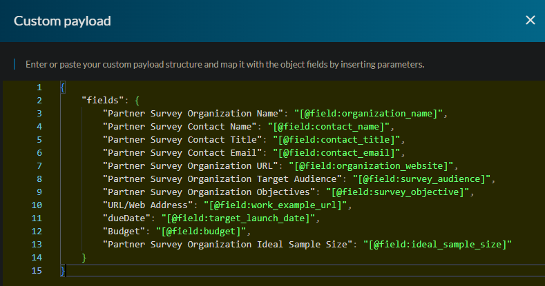

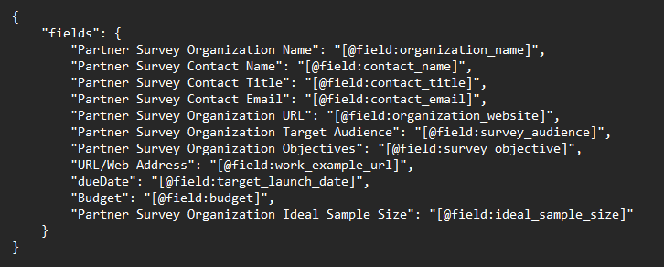

Caspio Webhook Custom Payload:

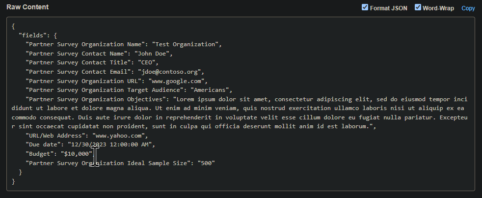

Result of Webhook Payload: This screenshot was from one of my early tests. This proves that the correct data is being pulled from Caspio and sent along in the payload. I know I will have an issue with the dueDate field as the data isn't formatted correctly. That's a 'future DQ problem'.
2023-12-11 17_34_25-Webhook.site - Test, process and transform emails and HTTP requests.png

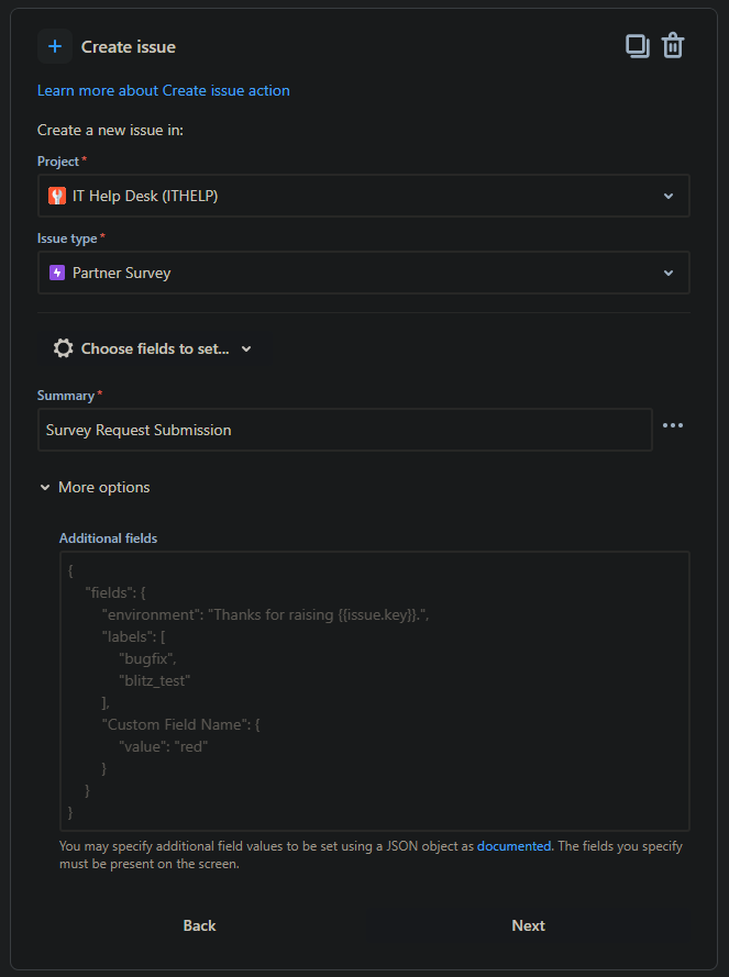

JSM Automation:
I'm showing the 'Additional Fields' section to show I don't have anything in it. Given that my previous tests of this configuration will create an issue, but not put data in the fields, I'm going make a wild assumption that we need to use the 'Additional Fields' section?
Is this were we would use the {{webhookData}} smart value? If so how?

Your JSON carries a payload in this order: Fields > Partner Survey Organization Name
A structure to use webhook if I want to retrieve this value in a field, I must pass the webhook variable with the field indentation. It would look something like this: {{webhookData.fields.Partner Survey Organization Name}}

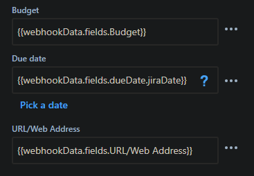

@Fernando EugĂȘnio da Silva thank you for your response. This does help me understand the indentation better.
I do have custom jira fields for all these pieces of data. I added the fields in my create new issue element, and put the smart value like this. Like before it creates my issue, but will not put the data into the Jira fields.
Do I need to first create the issue and then edit the issue later in the automation? Or do I need to add double quotes around the field names since some of them contain spaces? If that was the case I would think that at least the budget and due date fields pictured above would have worked with the rest failing...

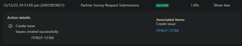

Could you share your audit log details? Jus to see what is the exactly error your automation is displaying.
David Quiram
December 12, 2023
That's the odd thing. It not failing. It's just not doing what I would expect.

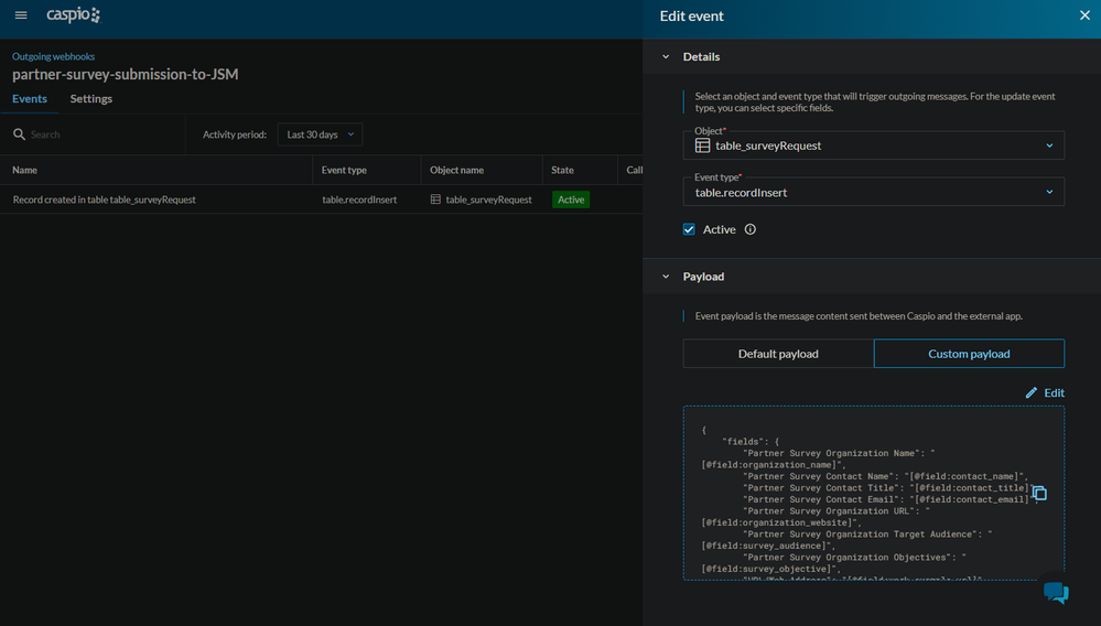

So as I mentioned in the original post. We are using Caspio, a low code database, to send the webhook and custom payload to our JSM project. The start of our automation is the webhook trigger.
I tried using Caspio's default payload, but it errors in the automation because of the structure. This is why we opted to try using a custom payload and I thought we were formatting in a way that Jira would be able to understand and use.
I feel like this IS being read by Jira, because when I forgot to add the (jiraDate) format variable to the smart value in the Jira automation, it would throw an error that the format of the due date was incorrect, because it does contain a timestamp coming from Caspio.
2023-12-14 13_34_17-Caspio - Webhooks.png2023-12-14 13_34_10-Caspio - Webhooks.png
