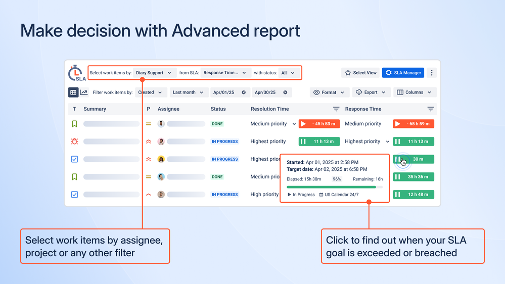

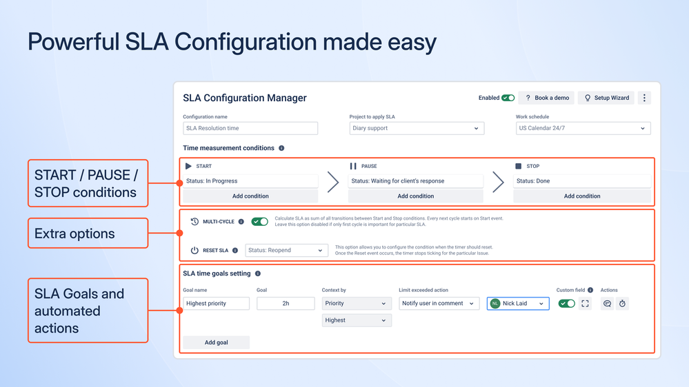

If you're open to using Marketplace apps, I’d recommend trying SLA Time and Report for Jira, developed by our team at SaaSJet. It offers a more efficient and scalable alternative to daily automation rules and complex field calculations.
Why this app can help:
Instead of custom field tricks and daily scheduled rules, you can:
What you can set up:
Bonus for you:
You’ll get centralized SLA data across your entire project, which is especially useful if you're managing a large volume of tickets and need visibility into progress delays, bottlenecks, or escalations – without burning through your monthly rule quota.

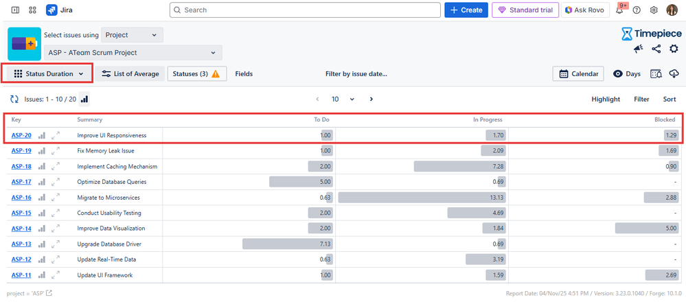

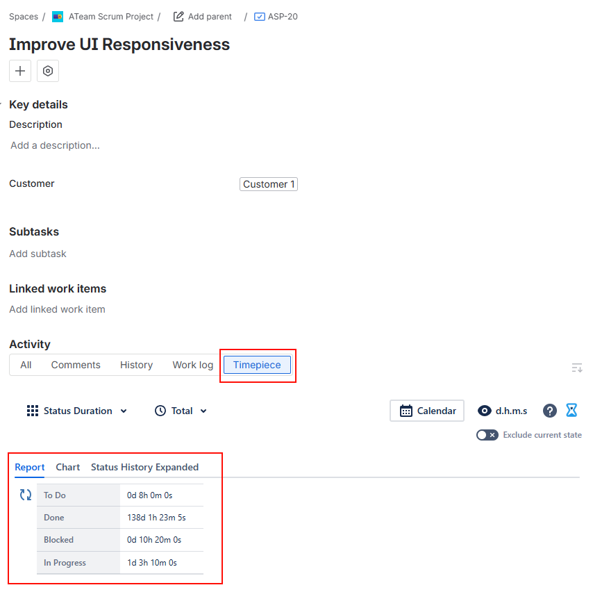

Full disclosure, I'm on the team that makes Timepiece - Time in Status for Jira, and it's designed to solve this without using any of your automation credits.
Instead of using custom fields and rules to store the value, Timepiece calculates "Days In Status" instantly from your existing issue history whenever you run a report. Our Status Duration report will show you how long every issue has been in its current status (e.g., In Progress, To Do), which is the exact data you're trying to get with your "Days In Status" field.
This approach has a few key benefits:
It doesn't use automation credits: Timepiece has its own reporting engine, so it doesn't consume any of your 5,000 monthly automation runs.
It's retroactive: It works for all your past issues immediately, not just new ones created after you build the rules.
It's more accurate: You can use custom calendars to calculate time based on your business hours (e.g., excluding nights, weekends and even lunch time), which is much more accurate than a 24/7 calculation.
I see you also built a scheduled rule to get a daily update. You can do that in Timepiece as well. If you want these reports delivered regularly, you can use our Scheduled Reports feature to have the system automatically email (or Slack and MS Teams) them to you or your team at any interval you choose.
You can check it out on the Atlassian Marketplace. Hope this helps you get the data you need.

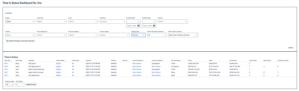

Hi @Ashraf B ,
You will have to either write your own app using Forge or Connect or if you are open to using apps you can use Time in Status Dashboard for Jira released by us.
You can filter using various criteria or display all results for a project without filtering if you wish.
You have access to two data perspectives, Columns and Rows. Each of those is displaying the time spent in each status and also times in status, meaning how many times the issue was present in a status.
Columns Perspective
Rows Perspective
