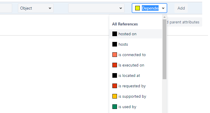

Each time you create a new attribute which is an object reference you'll see that the type of reference at the end can be given a specific name (basically the type of relation between the 2 objects)
By default there are only a few but you can add them on the fly in that attribute.

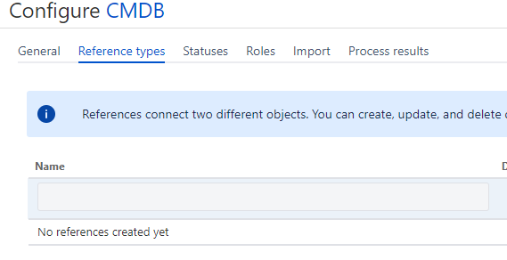

To manage them more globally you can either go to your "Object Schema"> "Configure" option in the top right (these are the reference types specific for that schema)

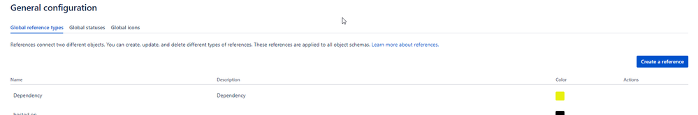

Or you can go to the general insight menu (top bar) and go to "Configure Insight" there you'll find the global reference types which can be used on all schema's
