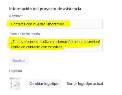

Im trying to change the name of the project and the name doesnt change
Laura Lloret
September 5, 2023

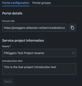

Hello @Laura Lloret
I just gave this a try in my own environment and I am unable to reproduce your issue. When I change the introduction text and press save directly below, the change is immediately reflected on the portal.
This is what I have done:
  • Go to the Project > Project Settings
  • Select Portal Settings from the left hand menu
  • Make sure the Portal Configuration tab is selected
  • Rename your project
  • Change the Introduction text
  • Press Save directly below the Introduction text fieldScreenshot 2023-09-05 at 20.36.19.png

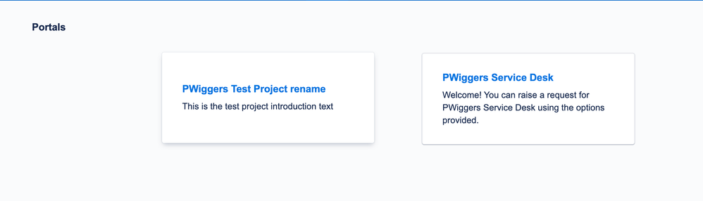

  • Reload your portal. The change should be immediate
I hope this helps you out. If this isn't what you mean, please let me know and describe the steps you have taken.

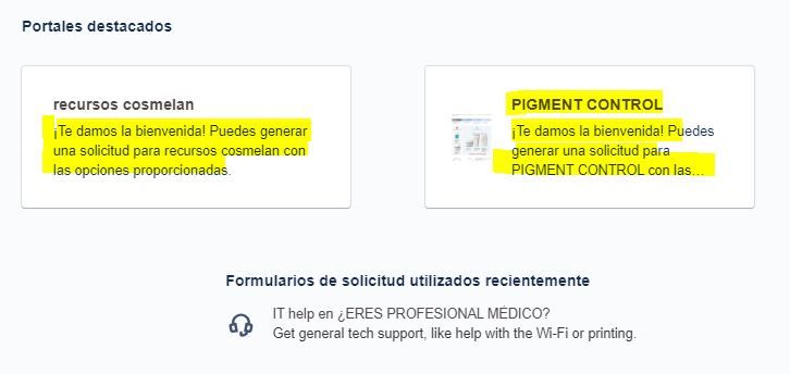

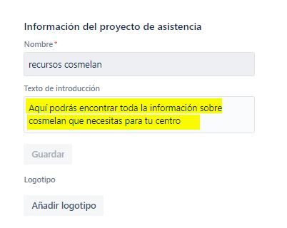

Laura Lloret
September 8, 2023
Thanks, the issue is now resolved. It was because I had configured several languages and needed to update and confirm texts. That's why the initial jira text appeared by default.
