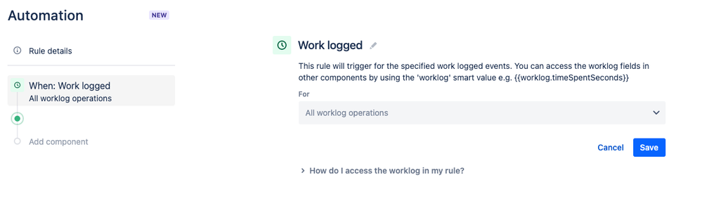

I am also not aware of a predefined action in Automation Rules that would allow you to selectively delete an entire work log record. There is a Send Web Request action that would allow you to interact with the Jira REST API, which would allow you to delete a worklog. You would first have to identify the specific worklog you need to delete.

Alternately you could modify the time spent on the last work log entry made when that entry causes the total time to exceed the Estimate. You can operate on the specific Work Log Entry by having a rule that uses the Work Logged trigger.
