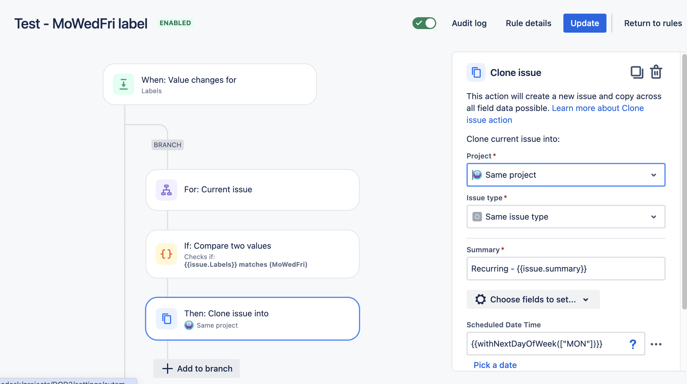

My goal is to create a label than when applied will create a ticket for every Monday, Wednesday, and Friday for the next month. For testing this, my automation is only trying to create a ticket for the next monday, but the ultimate goal is for my MoWedFri label to create 12 tickets (give or take depending on the month) for each Monday, Wednesday, and Friday in a month.
My automation is as follows so far:Screenshot 2024-01-10 at 11.00.55 AM.png
The JQL  logic seems to get ignored, so the ticket is cloned, but the field is not updated and the audit log will even say it's "successful" even though my definition of success is that the right date is applied.
I also tried using the logic:
{{issue.Scheduled Date Time.withNextDayOfWeek(["MON"])}}
which also did NOT work.
I am at a loss why this will create the clone, but not update the field "Schedule Date Time" to the value I want.
Els Bassant
January 10, 2024
Hi Samuel,
I believe the smart value should be {{now.withNextDayOfWeek("MON")}}.
  • It needs the "now" part to know where to calculate from.
  • The "MON" part should be without square brackets
Hope this helps,
Els

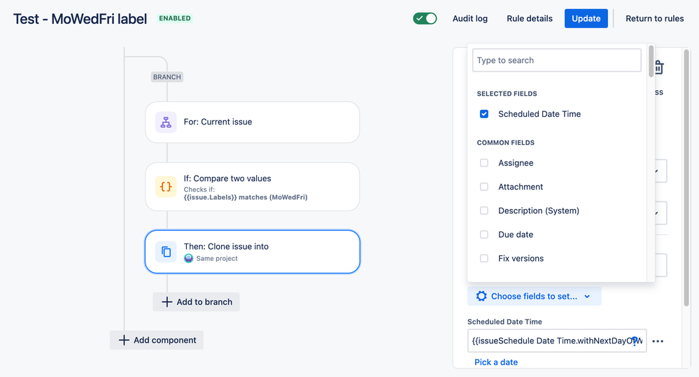

Els, thank you so much. That seems to work. I had tried to use the "now" value, before so I'm sure it was the square brackets that was the issue. I used the brackets after copying them from Jira's page with instruction on this value, so I am disappointed that was the issue.
Do you have any ideas how I can make it work without "now"? We want the label to work off the date within the "Schedule Date Time" value on the issue that we are applying the label to as opposed to "now".
So when I tried: {{issue.Schedule Date Time.withNextDayOfWeek("MON")}}, it again failed to apply a date, but it did create the clone.
The image lanaguge is  {{issueSchedule Date Time.withNextDayOfWeek("MON")}}, but i corrected it to  {{issue.Schedule Date Time.withNextDayOfWeek("MON")}} and it still did not work.

Els Bassant
January 11, 2024
Hi Samuel,
Sorry, I missed that it was based on that field. Assuming that "Scheduled Date Time" is a date field, it should work. I recommend double checking the field name and spelling.
{{issue.Scheduled Date Time.withNextDayOfWeek("MON")}}
You are missing the d in Scheduled.
So your original smart value was correct save for the brackets.
