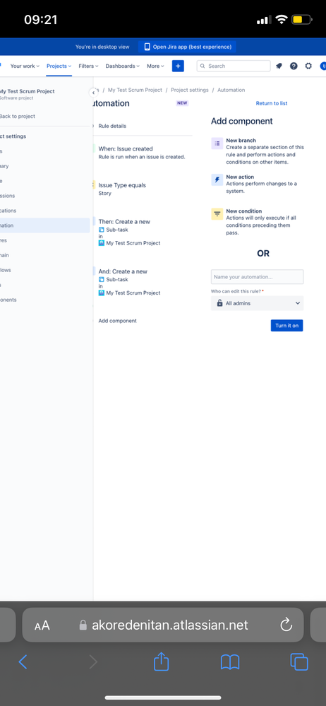

Anyway you could use the on create issue in automation’s page, add a condition to check issue type I’ll recommend a specific issue type for these tickets to avoid all issues that are created firing this automation and lastly use the create sun-task operation to create your sub-task. Close that you’ll like to set fields and then add the specific fields like assignee you want to set on the sun-task.
See the image attached as a sample:

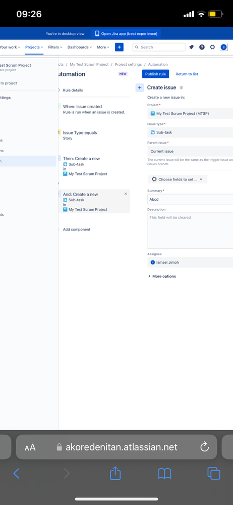

Ismael Jimoh
December 3, 2022
shows that assignee is set
