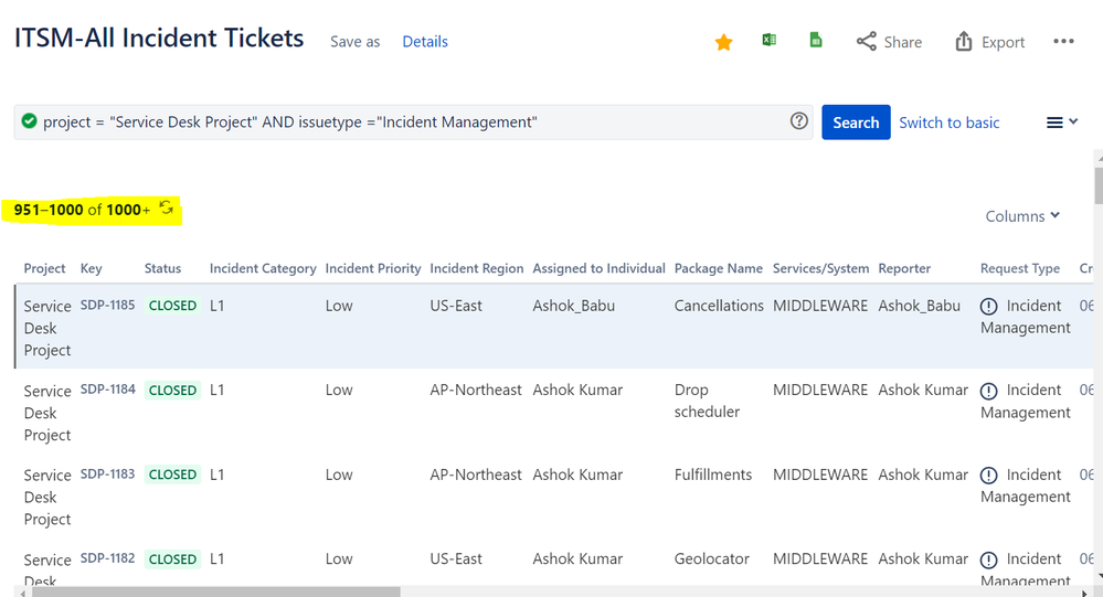

I can export only 1000 issues but it has 1026 issues please let me know how to export all the issues
Sreenadh
May 11, 2023
Hi,
I can export only 1000 issues but it has 1026 issues please let me know how to export all the issues.
Please find the attached SS.

@Sreenadh read the instructions provided. You have to change the parameters in the url bar.

Hi @Alex Koxaras -Relational-
I have followed the same steps and i can't able to download more than 1000 records.
Kindly help me out with the screenshots so that i can check from end.

Sreenadh
May 14, 2023
Please find the SS.

@Sreenadh
Do the following, as the instructions state as well:
  • Go to your advanced issue search
  • Search using your JQL
  • Export the first 1000 results using the "Export CSV (all fields)" option.
  • Go and copy the the link address from "Export CSV (all fields)". You should have a text similar to:
    https://YOURDOMAIN.atlassian.net/sr/jira.issueviews:searchrequest-csv-all-fields/temp/SearchRequest.csv?jqlQuery=order+by+created+DESC&atl_token=5c77cb78-0a74-4462-bd2a-0d499837913c_9d2c70d058c480e7e92009f94d9298ed6a12d275_lin&tempMax=1000
  • On the above link add on the end the following
    &pager/start=1000
  • Hit enter and this will export the rest 1000
  • Repeat the process by increasing the &pager/start by 1000
