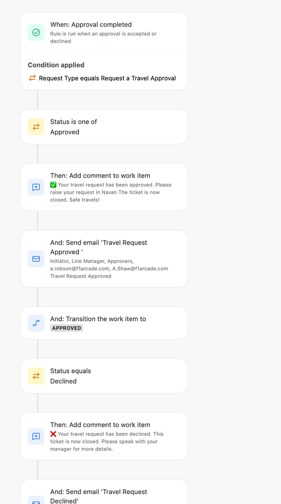

I am trying to set an automation so an email is sent to the requestor when their request is approved
Ashley Robson
July 30, 2025

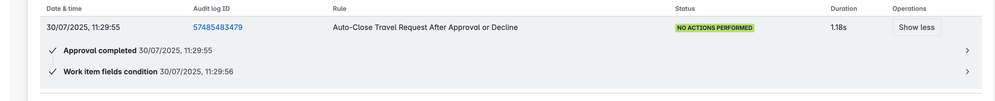

It shows No actions Performed in the audit and the email isnt sent and the customer note is also not sent
Evgenii
July 30, 2025
Hi, @Ashley Robson
There's an issue with your rule logic — you need to use an IF/ELSE condition.
Based on your screenshot, if the status is "Declined", the rule will still first check whether the status equals "Approved". Since that condition fails, the rule stops there and doesn't proceed to evaluate the "Declined" branch.
By using IF/ELSE, you ensure that only the relevant path is evaluated, and all possible outcomes are handled correctly.

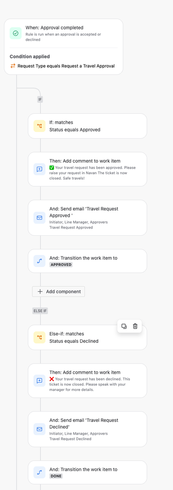

Ashley Robson
July 30, 2025
Thank you for your answer I changed it and it still shows no activity
The logic appears correct but none of the steps are occuring< I know im missing something Please help :)

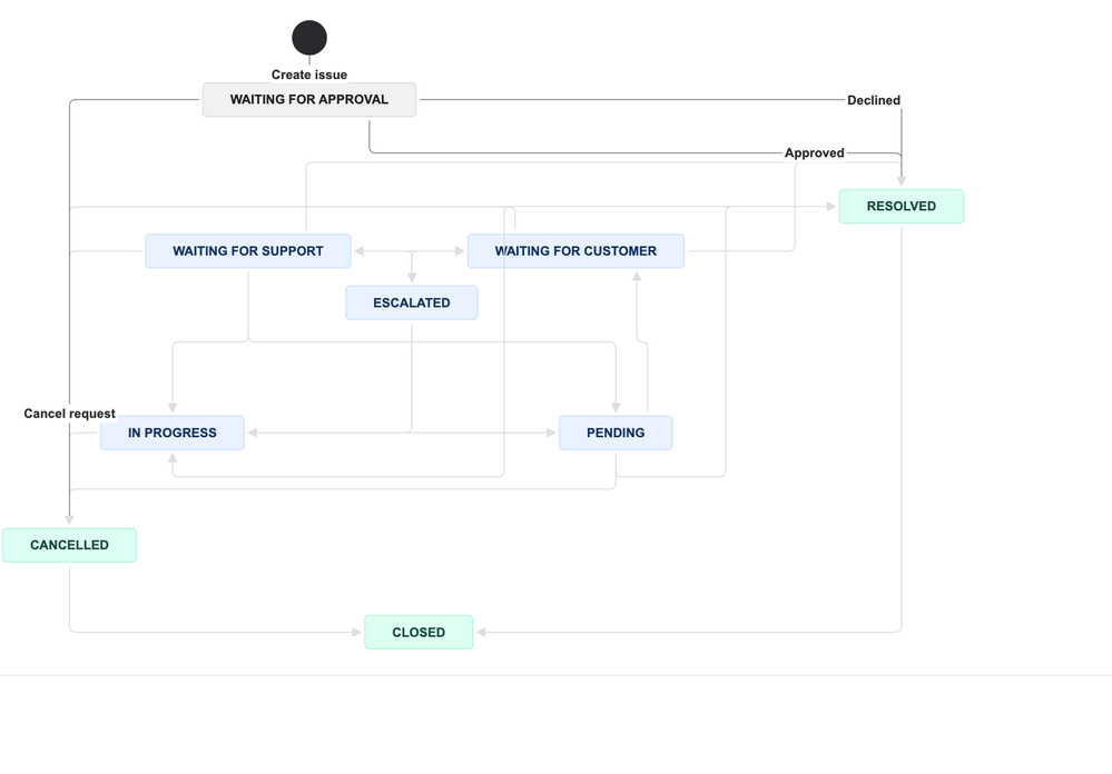

Hi @Ashley Robson
How is you approval configured in the JSM workflow, with the approval option or just transitions based on status change?
To use the approval trigger in an automation, in a workflow an approval has to be configured, see
add-an-approval-to-a-workflow
Ashley Robson
July 31, 2025
Marc this may be obsecure would I be able to have a video call with you to walk through ?
Marc -Devoteam-
July 31, 2025
Hi @Ashley Robson
Can you provide a screenshot of the workflow and the status where the approval is configured?
Ashley Robson
July 31, 2025
Screenshot 2025-07-31 at 11.01.40.pngI want the workflow to run off approval and then be set to done

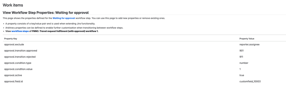

Marc -Devoteam-
July 31, 2025
Hi @Ashley Robson
Please select the status "Waiting For Approval", is the checkbox "Include Approval Step" checked, if so what is the configuration look like?
Ashley Robson
July 31, 2025
Screenshot 2025-07-31 at 12.02.32.pngdo you mean this ?
Marc -Devoteam-
July 31, 2025
Hi @Ashley Robson
You are showing the properties.
Just select the status in the workflow and then there should be a view of the status on the right.
There should be a checkbox before: Add Approval, is that enabled, if yes, what is the configuration (select) the configuration option
Please provide that screenshot?
