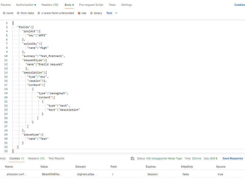

I am trying to create an issue using Jira REST API on Postman, Getting status 415 Unsupported media

I just tested below JSON and it worked..
Also share what response you are getting trying below version.

Screenshot 2024-03-27 201419.pngI have tried with Request type and without request type which is mandatory field but still it's same

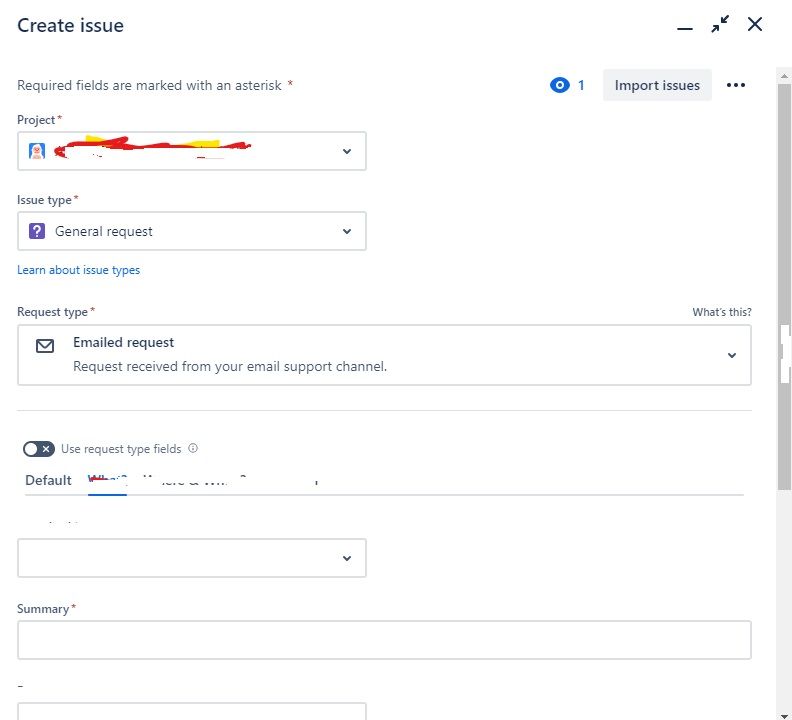

Here is my Issue create page. Does it required any Api permission to get into Jira JSM, I have a Administrator role.

Please cross check what you have for content-type in your header, should be application/json
See below:
https://community.developer.atlassian.com/t/post-api-call-return-error-415/62992
AI
March 28, 2024
Grate! its worked, Content type was text/html changed to application/Json.
