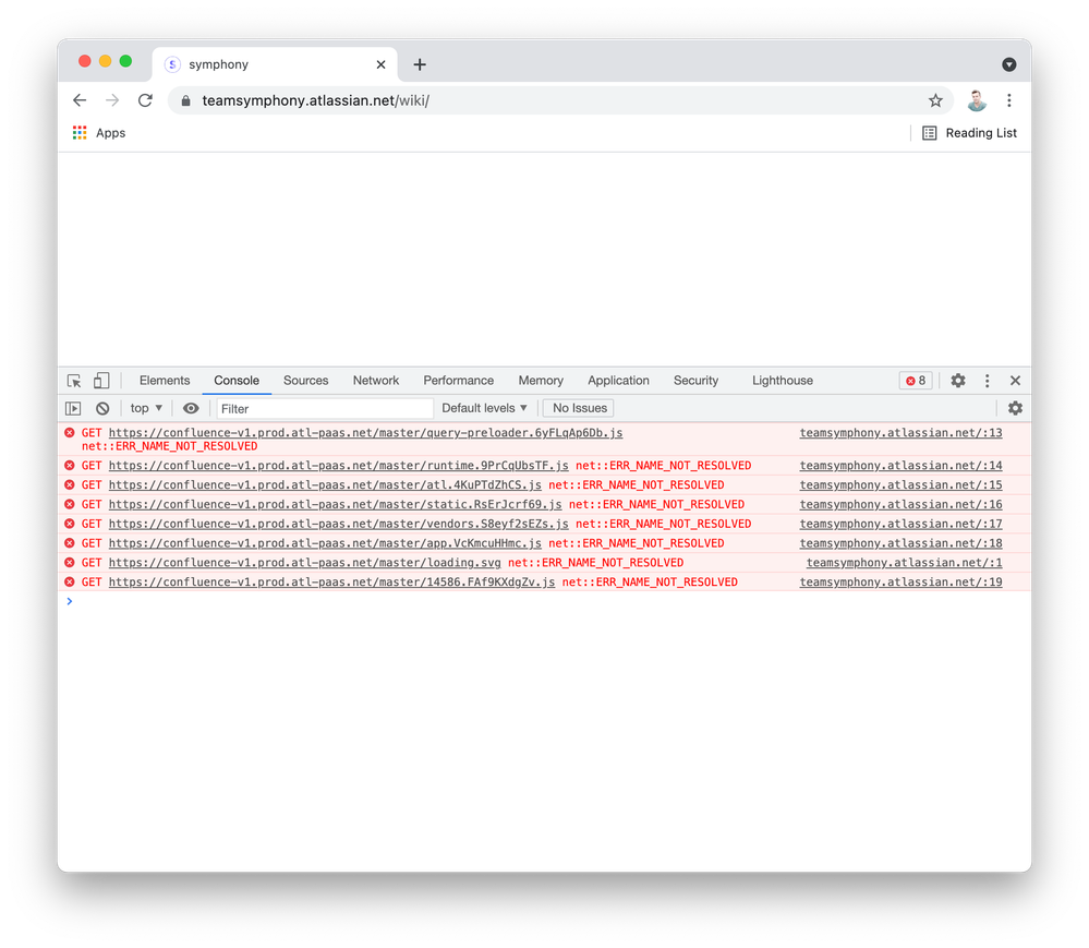

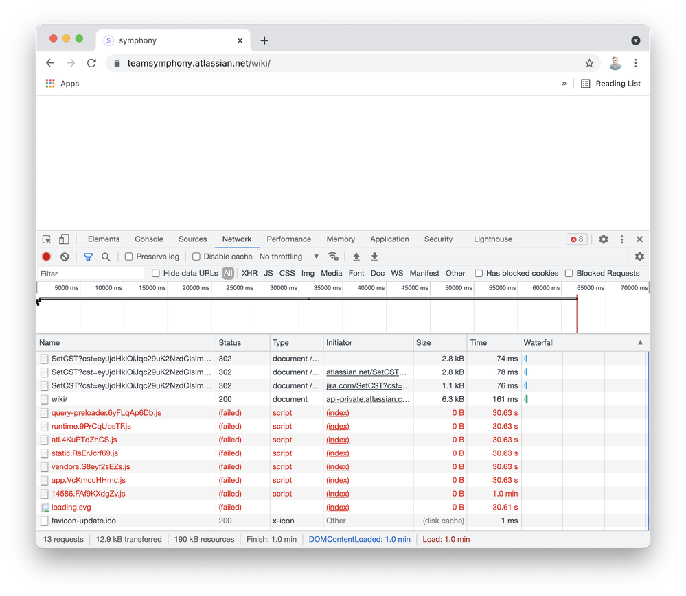

Hi. I am facing the issue shown below. I have access rights. Could someone help me to solve the issue? Thanks.
Browser: Chrome v91.0.4472.114 (Official Build) (x86_64)
Operating System: macOS / Big Sur v11.4

The issue was caused somehow by internet provider. I had to configure my network settings to use the IP address 8.8.8.8 as my DNS server.
