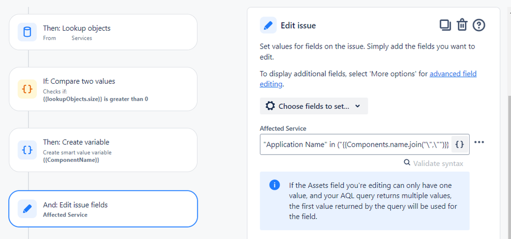

Thanks guys, I totally forgot on this post.
I managed to find a solution with help from Atlassian Support:
  • first, I do an Assets Object lookup where "Application Name" IN ("{{components.name.join("\",\"")}}")
  • if there are Objects found - checking this by smart value condition if {{lookupObjects.size}} > 0
    • I create new variable ComponentName with smart value {{lookupObjects.Application Name}}
    • Finally, I update my Assets custom field with this value: "Application Name" in ("{{Components.name.join("\",\"")}}")
It  looked a bit strange to me, but it works as desired.
Hope it will do the same for someone else too :)

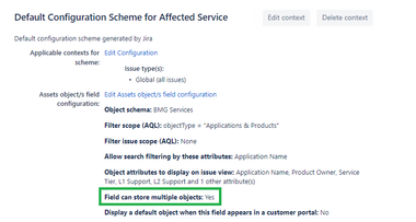

What is the config of the Assets CF looks like.
I think it might that the option multiple is not enabled in the Asset CF field.
Klime Buneski
November 28, 2023
Hey @Marc -Devoteam- , thanks for responding.
Below is the field configuration, the option is enabled and manually I can add multiple objects.
I cannot do that via the automation.
Best,
Klime
