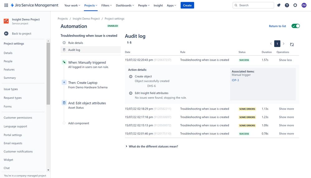

Trying to plan out an ITSM build whereby JSM agents would update an insight asset status from the JSM ticket. Presumably using an automation rule.
I have followed these instructions: How to update Insight Objects attribute using automation with values from associated Jira issue | Jira | Atlassian Documentation
But on running of the rule I get this error message:
Edit Insight field attributes
No issues were found, stopping the rule.
It sounds like the automation rule is looking for issues to update and not assets or possibly some other bug. Am I doing something else wrong, or is there an alternative approach?

Paul Mackie
July 17, 2022
Hi @Robert Wen_Cprime_ for context the create object rule was part of the debugging I was doing, i.e. create an object with 1 attribute, and then use the rule I wanted to test to change the newly created object's status.
After a call with an ex-colleague I found out that the "Edit object attributes" rule I was using was the incorrect rule for what I was trying to do.
The correct rule for anyone else attempting to achieve similar is called "Edit Insight field attributes" - which confusingly is not under the insight automation rules (rather, the Jira issues) tab, however is the rule name is correct in the documentation linked in my original question.

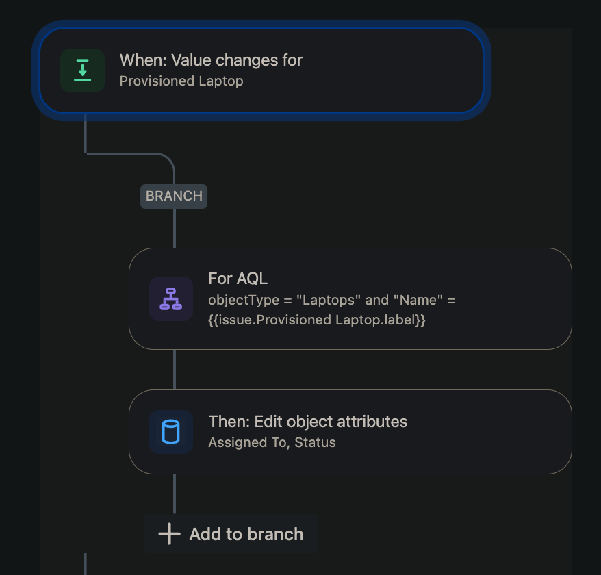

Richard Malone
October 25, 2024
I came across this while troubleshooting my own problems and thought to add some detail on how this has changed in the time since this was first raised. The support documentation in original post is out of date.
This is for Jira Cloud
Automation must be set in a global context in order to use AQL Branch.
My trigger is when a value is added to my selected Assets Custom field.
I then add an AQL Branch, where I set my Asset search criteria
Then I can edit the attributes of the selected object.

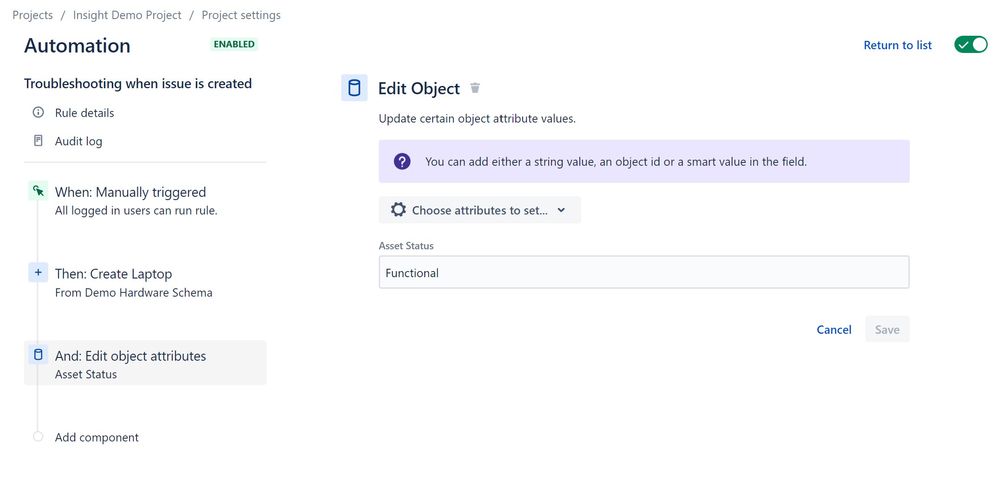

Paul Mackie
July 15, 2022
So this is a test rule, that creates an asset, DH-6, which is successfully created, however the final part of the rule "Edit Asset Status" has been saying that no issues are found (I presume it means assets) but there is nowhere in the rule configuration to specify which asset should be updated.

Robert Wen_Cprime_
July 15, 2022
Out of curiosity, why do you have setting attribute values as a separate action?  I believe you can set attributes while you Create the Object.
