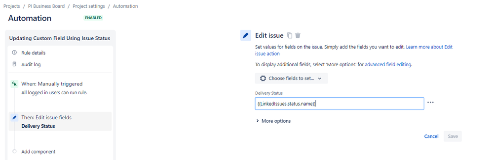

I have been trying the entire morning with no success, which just makes the custom field "empty" let me paste here what I did

The smart value you tried to use here is not a real smart value. Were you referencing some documentation or post that made you think it was?

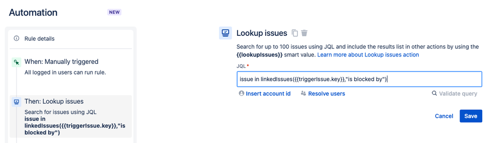

Knowing so far that you want only the linked issue(s) that use the "is blocked by" link, we can start by saying that you need to use the Lookup Issues action to get a list of all the linked issues that use the "is blocked by" link. The Lookup Issue action uses a JQL to retrieve issues.
From the Advanced Searching - JQL Functions page we know that we can use the linkedIssues() function.
  • Find issues that are linked to a particular issue via a particular type of link:
    issue in linkedIssues(ABC-123,"is duplicated by")
We can get the issue key for that statement using a smart value. {{issue}} references the issue in context at a given point in the rule and the issue in context may change as you progress through the rule. You can use {{triggerIssue}} to make sure that you reference the issue that caused the rule to be triggered. You add the field name that you want from that issue into the smart value. Double curly braces surround the smart value. You can find more information on available smart values here.
issue in linkedIssues({{triggerIssue.key}},"is blocked by")
The result set from the JQL will be stored in a special list smart value named {{lookupIssues}}
If there is a scenario where there might be multiple issues in the result set, and you only want to consider one of those issues, then we need another criteria we can add to the JQL to zero in on that one issue.
