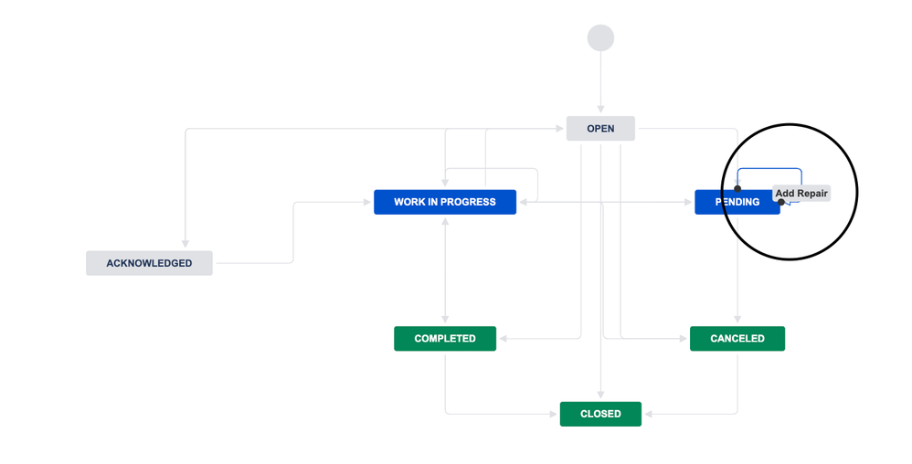

I am trying to understand what can trigger a screen like this.
I know that both task creation and status transition can trigger this. Is there another way?
For example, can we do it via a manual automation action?  We want to have some custom action without relying on third party app. Having it in the status transition is fine except we don't want to actually change the original status.

Trudy P Claspill
May 1, 2023
Is the problem that the issue needs to stay in the status it starts in? If you need it to stay in the status the you create a self reflecting transition, where the From and To status are the same. You can then attach the screen to that looping transition.
Like Nic Brough -Adaptavist- likes this
Zekai Huang
May 2, 2023
It sounds like what I am looking for. Do you know why the self-reflecting transition type doesn't appear as an option in my workflow dropdown. But if I click view the workflow, I can see it.
Like Maria Rusnakova likes this
Zekai Huang
May 2, 2023
Or if I misunderstand how the self-reflecting transition work, how to trigger the transition? Is it expected to see the self-reflecting transition option in the workflow dropdown?
Zekai Huang
May 2, 2023
Ahh, found it. It shows up in the action tab. Let me test this thoroughly and come back to accept this as an answer.
Like Trudy P Claspill likes this

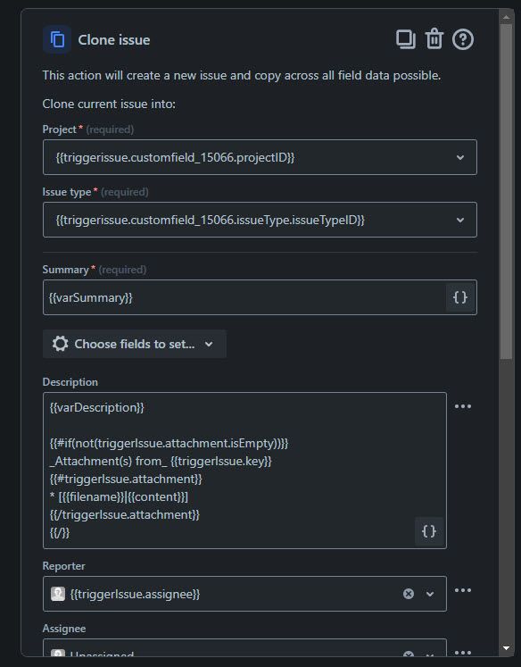

Kevin Christmann
May 17, 2024
You can use a workflow screen to create an issue in another project. We do it but it is in a pretty complicated manner. We also use Jira Assets (which requires Jira Service Management Premium) to do this. I think, however, that you might be able to do it without Jira Assets.
Here is what we do:
  1. Upon transition we fire a screen we created.
  2. That screen contains custom fields that asks the user A) what project to create in B) desired summary C) desired description
  3. For us, those custom fields are Jira Assets fields. Where we store detail about our Projects including thigns like Project Key, the Issue Type to be used for that project etc.
  4. Then in our automation we essentially do the following
    1. Trigger = issue transitioned to <status you choose. We made one called "Spawn Request">
    2. We check if they provided desire summary and description. If they did we put that into a variable we created. If they did not, we take the summary and/or description from the original ticket  (using Jira smart values) and put that in a variable
    3. Ultimately we use a Clone issue action that clones the issue into the project that was chosen and all of the other things I mentioned above. Here is a screenshot of our step for that. You can likely ignore the attachments piece.
