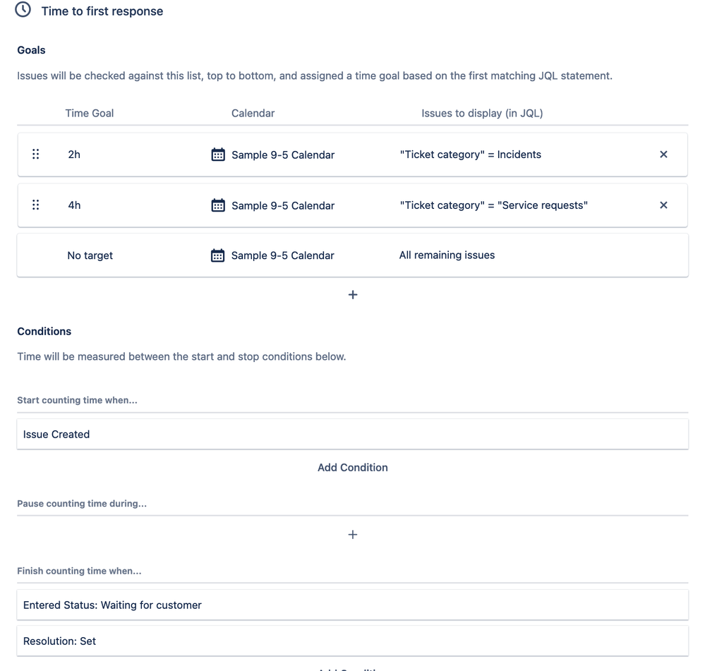

Hello @Kuba Grzelczak,
The best way to track the response time is by using SLAs.
In this case, it’s necessary to confirm that the bot comment won’t transition the issue, so it’s possible to use the SLA “Time to first response” to pause when the status is changed to, for example, Waiting for customer.

Angélica Luz
July 30, 2021
It’s possible to use another SLA. Let’s say, for example, when the bot adds a comment, the ticket is transitioned from Triage to Waiting for Support, then it’s possible to start the SLA when it enters this status.
When using the SLA it’s only possible to use those options on “Start counting time when…”, it’s not possible to set when a comment is added by someone in a specific group.
