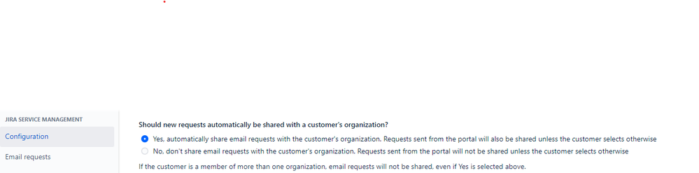

I also find this option in the jira administration menu. Is it related ?
