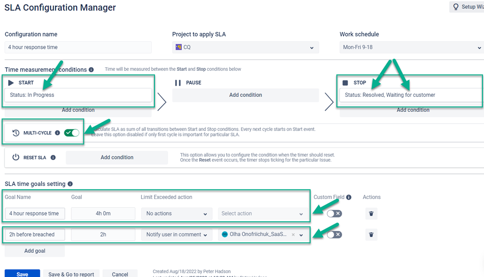

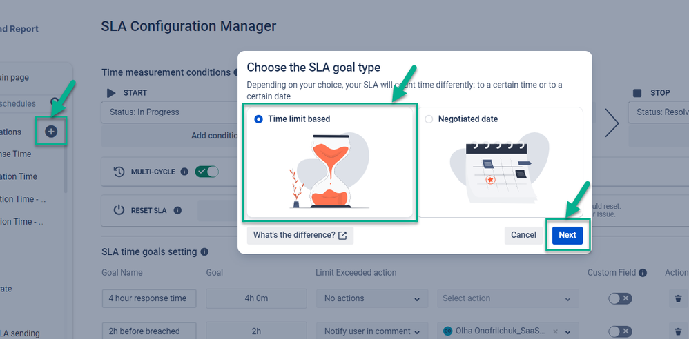

Hi, @Mohammed Arafat Naidoo
I would recommend you to try SLA Time and Report for Jira add-on to meet your goals.
To do what you described in your question, you just need to create a new SLA Configuration, choosing the "Time limit based" SLA Goal type.tlb.png
Then select the Start and Stop Conditions (like in the screenshot), multi-cycle option, and time goals:response time.png
Hope that's what you need.
In case you need any help or more detailed information, just let me know. And my SaaSJet team will help you to configure everything you need for the most effective work with SLA Time and Report for Jira add-on.
