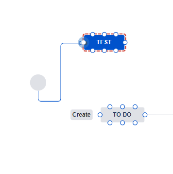

You should be able to set the status for the issue on creation in the workflow.
In this example, the workflow was set so that, on creation, the issue is created with the status, 'To Do'.  But, if you wanted the issue to have a different status when it is created, you can just drag the arrow on the left that goes into the 'To Do' status and attach to another status in the workflow. Now, when I create an issue that uses this workflow, it will have the status of 'Test' and then move on from there in the workflow.

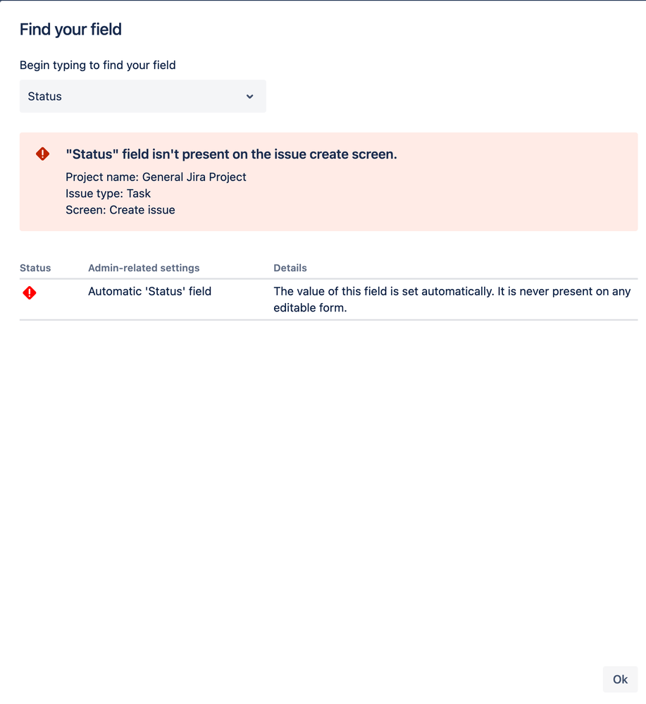

Hi @Valerie Knapp Thanks for posting the answer, but you quite not understood my question. Let me explain it again. While creating the issue, I may choose different status according to use case. See the another project, how that option is coming.

This screen is telling you that you cannot add Status to the issue create screen, but it should be there by default, as you saw and as I have seen if I go to create an issue.

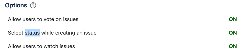

I saw your LinkedIn post and checked my settings too. In my settings, it is "ON", but why "Status" dropdown option is not coming while creating the issue, that is my question.

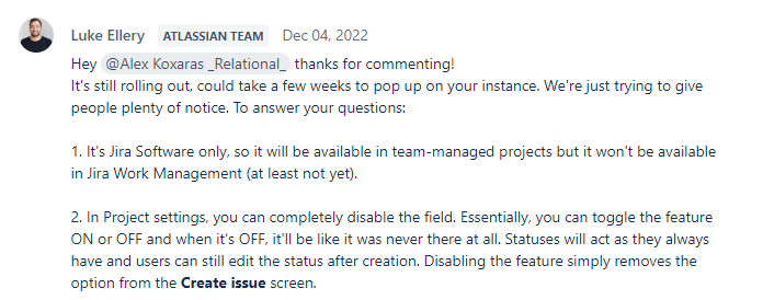

If I get it right you are now trying to do the same on another project but the field is not showing up at creation? (like @Valerie Knapp if the feature is turned on there should be no need to add the field on a screen ,it should just be there).
The project where you are missing the status field what type of project is it?
Jira Software or Service Management?
In the comment of the announcement you can see it mentioned it's only for Jira Software
so if you are trying this in a Jira Service Management project it's probably not working (yet) in that project type (as you posted this in the JSM group)
If you also need this on JSM I suggest to comment on the Article or raise a support request (https://support.atlassian.com/contact)
