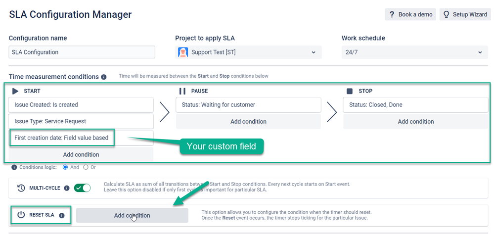

If you create a custom field for the "Incident" ticket with the date of creation of the initial "Service Request" task, you can configure the SLA with the add-on as follows:
Select Issue Type: Service Request, Issue Created: is Created, and your Custom field for the Start condition. For Pause – Status: Waiting for Customer, and Stop – Status: Closed.
I did not fully understand what condition you need for the Reset SLA, but the configuration has a separate field (see screenshot).
This app also has a 30-day trial period, so you can also try this option for free. Furthermore, you can book a Demo call, where our manager will help you set it up.
