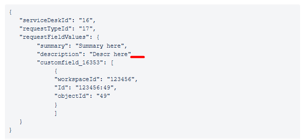

[!! SOLVED BELOW !!] Using the API Post to rest/servicedeskapi/request, (docs) I can insert a JSM ticket, but when trying to set an asset object, it fails with a 400 (There was an error parsing JSON. Check that your request body is valid). The custom field (16353) is backed by the JSM Asset object and is on the create screen. 123456 would be my workspaceId and objectId 49 is the correct asset object value I want to set this field to.
"serviceDeskId": "16",
"requestTypeId": "17",
"requestFieldValues": {
"summary": "Summary here",
"description": "Descr here"
"customfield_16353": [
"workspaceId": "123456",
"Id": "123456:49",
"objectId": "49"
I also tried this approach with the same error.
"customfield_16353" : [{"id": "123456", "objectId": "49", "workspaceId": "123456"}]

Christopher Yen
April 11, 2025
Hi @Paul Alexander , I think you're missing a comma after description which could trigger the error parsing JSON
2025-04-11 15_32_44-How to set Asset object field when creating JSM ti....png
Paul Alexander
April 11, 2025
That missing comma fixed got me a bit further. I also realized that while 49 is the asset object I need to access, I am not choosing a value of that object to set it to. Perhaps someone could post a solution to setting an asset object to some known value of that object. Thanks.
