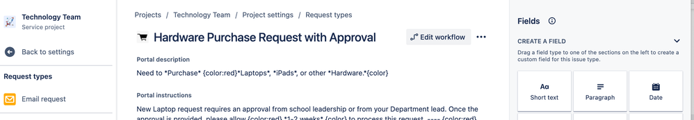

I have a similar issue but not sure where to ask for help. We are using Team Managed Project. We accidentally created several duplicate fields in Request Types. I've delete it from both the form as well as the right panel but when using advance search, these fields are still showing up. For example, we accidentally created a second field called "First Name." I've deleted it in from Request Types page. I then performed an advance search and it still shows 2 First Name fields. Not sure if I'm doing something wrong or if there is a different solution.

Removing it from the Request Type page doesn't remove the field from Jira.
You will still need to remove the field from the field section on the project.

Thank you for your reply. We are using Team Manage Projects. I don't see a Fields section. The only Fields section that I see is a side panel to the right of the Request Types window. If it is here then I've deleted it already.

Then it should be gone, or another team managed project in your instance uses a field with the same name.
This is due to using team managed projects. They are like containers, fields made in team managed projects only exist in their project and not in others.
If you want to make use of a single field in all projects and not have duplicate ones. Your only option is company managed projects, as they are able to share custom fields in the system

Because other teams have the same name, I will need to change the naming standard for all teams so that they each will have their own unique field names.
