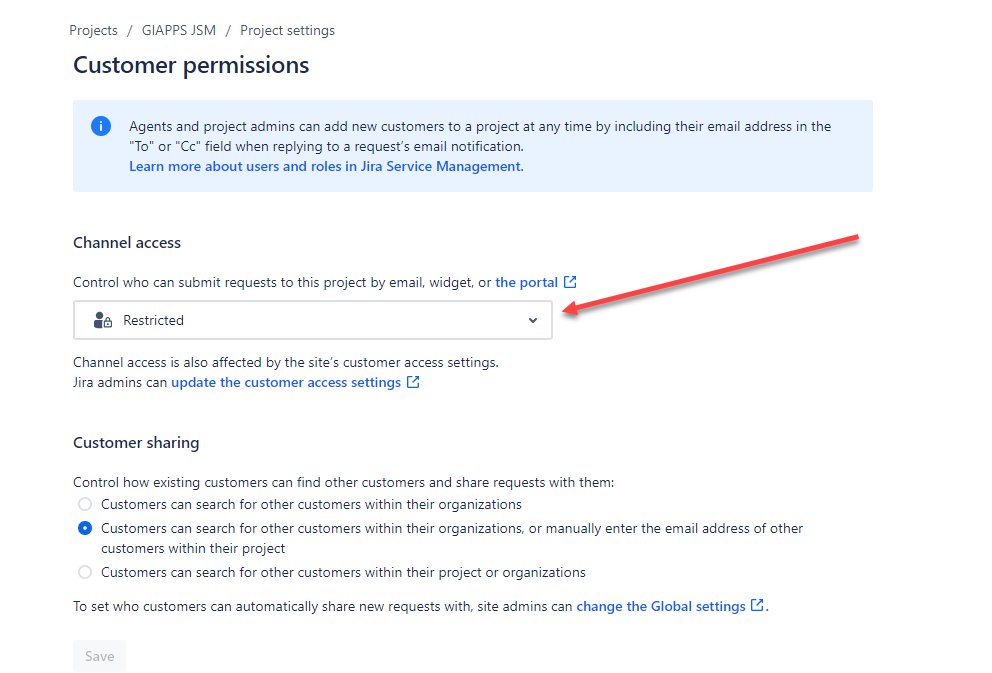

@Per Hallenborg -
What you need to do is to control project access via Project settings >> Customer permissions to set the project visibility inside the portal -
Then you need to make sure the the proper users or group for accessing your project are setup properly.  So if users/groups are not called out for accessing against the specific projects with the "Restricted" Customer permissions setup, then he/she will not see the project(s) within the portal UI.
Hope this helps.
Best, Joseph Chung Yin

Thanks. So if I understand it , we need to set Restricted access to all projects in order to make them not viewable?  Since we have all our projects Open, then we can't restrict access.
