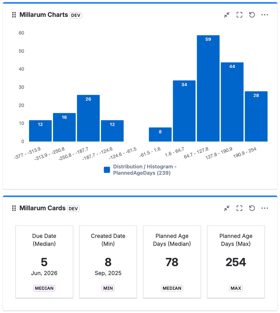

As you mentioned Power Bi, may I suggest Millarum Dashboards?
This add-on uses the concept of a slicer directly in Jira, where the dashboard is created once and the data can be changed on the fly through the slicer.
Also includes histogram and pareto charts to analyze numerical vales graphically, and the cards widget support the common min, max, sum, mean, mode, median among others.
Here I share an example of a histogram and cards used for reporting purposes. I hope you find it helpful.

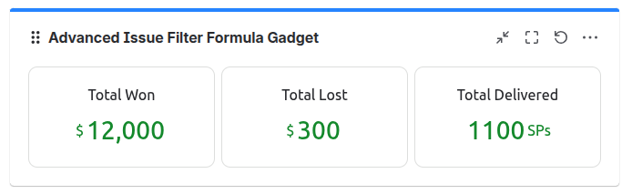

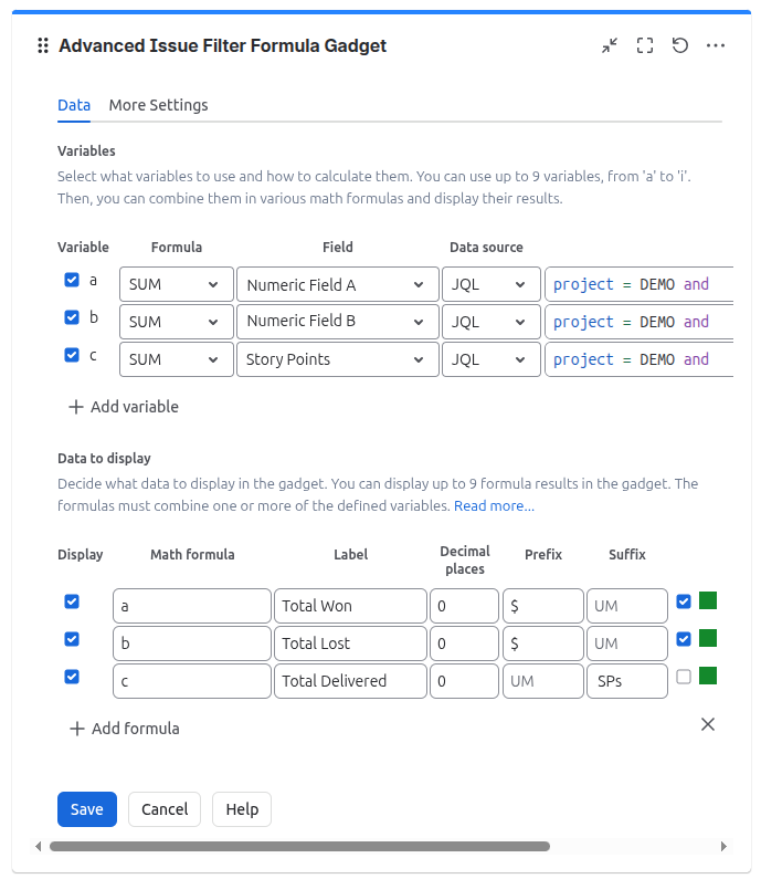

If you just need this as cumulative numbers (sum of that field), you could use the Advanced Issue Filter Formula gadget to get the numbers displayed on your dashboard. This is just an example:
The gadget is higly configurable. For this example, I used something like this:

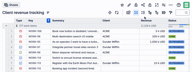

If you'd like the totals to stay inside Jira and you're open to a Marketplace app, this is a natural fit for JXL for Jira. Its sum-ups compute the Sum (or Average, Min, Max, Count) of any number field. You can show a running total across the whole JQL-scoped sheet, or group by a field like Status to see quoted vs won vs lost vs delivered totals side by side. It works on Jira Service Management projects too.
sum-up-client-revenue
Disclosure: I work on the JXL team.
