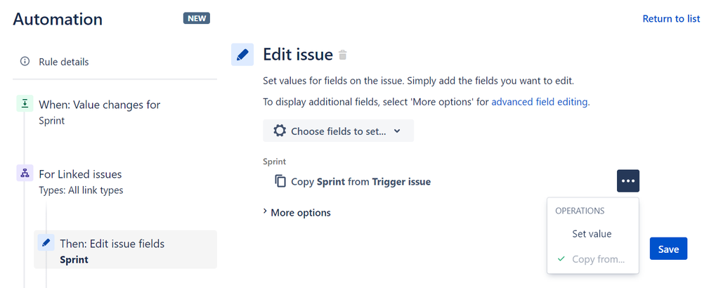

I am automating scenario where I have put trigger condition as change of field "Sprint"
if this field is changed, then it will check Linked issue and copy the Sprint field from trigger issue to Linked issue.
I am also generating email to reporter with reference of Sprint version. Now I am not able to understand how do I refer to Sprint version of trigger issue. I am using {{Issue.sprint}} but that doesnt return the right value as this rule is under Linked script.
Would it be something like {{issue.triggersprint}}?

You should use a Branch in the automation rule and set this to action all of the linked issues.
Then using an Edit Issues action under this branch, selecting the Sprint field from the dropwdown, you can click on the 3 dots and select Copy from, and select the Trigger Issue as seen below.
You can then either add the email action directly under the Edit Issues action (which will send the email to reporter of all of the linked issues) or you can add the email action outside of the branch, which will only send the one email to the reporter of the triggering task.
