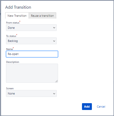

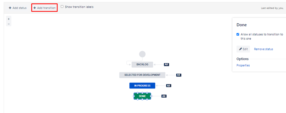

Hey @Jeanne ROBERT
Try this button and transition by selecting the status in dropdown like this
