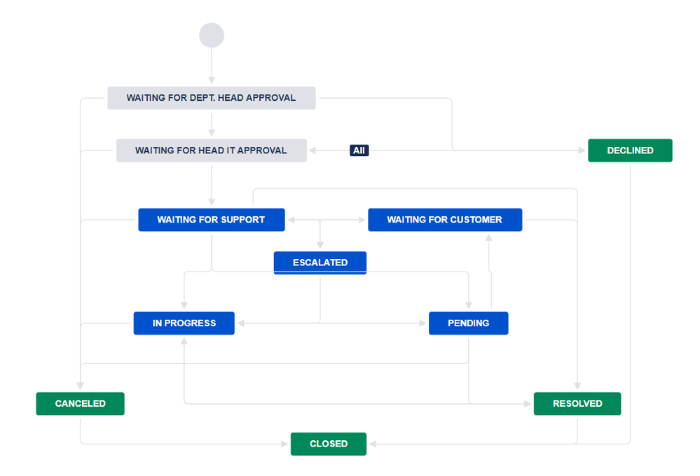

Hi,

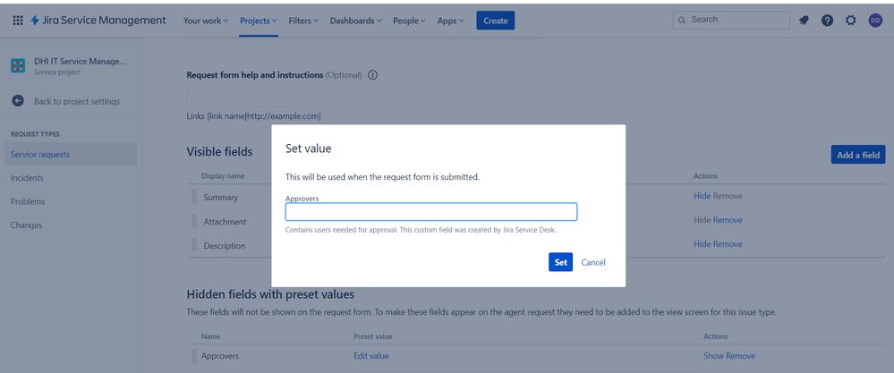

I have a problem setting the approvers for that kind of workflow (pic.1) for my company because when I move to the Approvers field (pic.2), that was only 1 field of Approvers that can visible. The line "Waiting for Dept. Head Approval" must be contained for 1 head but it depends on each department. So the Dept. Head Approvers should be different depends on the tickets that were created by the user.
How can I set up the Approvers for that kind of need? I knew that the Approvers are not mandatory to be an Agent, so we don't have to create a group for Approval, right?

First of all let me inform you that Approvers is a multi user field, meaning that you can pick more than one approvers. One you've activate your workflow, you will be able to setup your approval (if one or more approvals are needed).

What I would do is:
  • Create one more custom field (multi user) called Head IT Approvers
  • Assign this field to the Head IT Approval
  • Have the agent set in the beginning the two people who are going to approve this request:
    • Approvers field will be used for the Dept Head Approval
    • Head IT Approvers field will be used for the Head IT Approval status
In theory the above should work, although I haven't tested it. Would that solution work out for you?

Hi, @Alex Koxaras -Relational-
Yes, I have tried your suggestion and it's working for me. Thanks a lot for your help.
