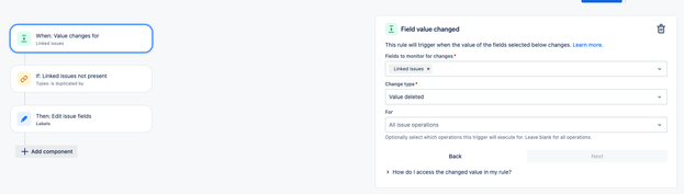

January 9, 2024
Hi @Chloe Allison
Welcome to the community.

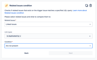

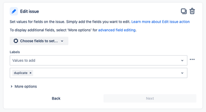

It might that the following rule, will achieve this.
I just made a mock-up as I didn't have time to test it.
Screenshot 2024-01-09 at 17.49.31.pngScreenshot 2024-01-09 at 17.49.38.pngScreenshot 2024-01-09 at 17.49.45.png
