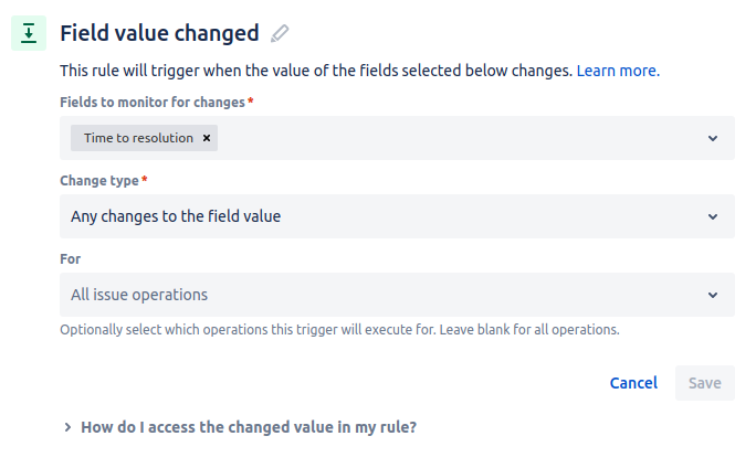

Hi there! I create a Jira Service Management automation, so that I have the breach time of one SLA copied into another field of the issue (due date in this case). I use "Field value changed" condition, as illustrated here (name of my SLA is "Time to resolution"), but unfortunately it does not seem to fire, any chance to make that work?

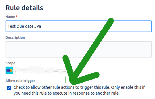

NB: I also tried to select this option:
but it does not give any solution.

- I tried to use "Field value changed" trigger, and my SLA is proposed in the list (I can see "Time to resolution" proposed). But unfortunately, this trigger does not fire when the "Time to resolution" service level is updated.

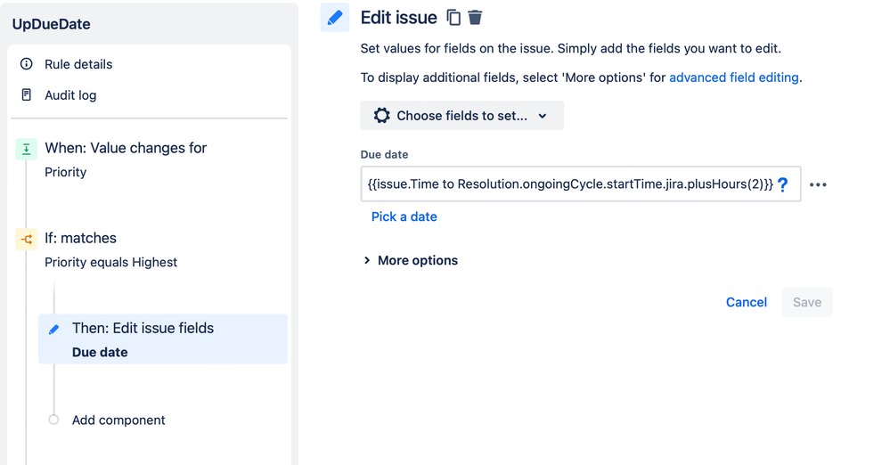

1) you could set the trigger to "Field Value Changed" based on your severity field, then, instead of trying to copy and paste from your SLA as you mentioned, simply calculating the Due Date separately. You would need an if/else condition block, checking for each of the severity fields that maps to a specific SLA goal, and then setting the Due Date accordingly.
As you can see in the image (I don't have your Severity custom field, so I used priority), if you use the start time smart value {{issue.Time to Resolution.ongoingCycle.startTime.jira.plusHours(2)}}, you can add the hours (2 for critical, 8 for major, 56 for Medium). The only concern I would have with this is the major and medium goals are based on the business calendar, so you would want to somehow figure that into the calculation. This might be overly complex, so this solution might not be what you want. Smart Values can add based on Business Days (.plusBusinessDays()) but that's days, not hours, and their business day is 9am-6pm, when the sample calendar business day is 9am-5pm.
