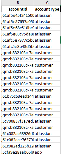

Deivid Araujo
January 22, 2024
Yes, it does:
How many users do you have in your instance, approximately?
Lars Morten Nygaard
January 23, 2024
You are perfectly right, Customers was certainly there, but after the intial search response set size.
Thanks for you support and patience.
