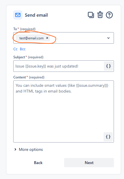

What I should write on Audit Log field when I need to get values from Send email action?
I have Automation in Jira Cloud and now need to see what e-mail did get notification. To field value will be different if JQL get another result. But all e-mail are writen into To field and not come from Jira tickets.

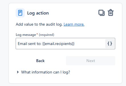

I try to use {{email.recipients}} but it does not work.
Right now it write into Audit log so:

Hi @Urmo , you can't log the list of recipients in that way. May I ask how the list of recipients are being determined for the send email action? Can you share more of your automation?

Unfortunately the email is not stored anywhere on the issue data, so you will not be able to access it like this. If this is a requirement my advice would be one of the two ways:
Option 1 - Duplicate your information
After each "Send Email" action, create a "Log action" action and have all the same information manually input. You need to remember to update both actions if there are any changes.
Option 2 - Use variables
Use the "Create variable" action for each part of the email you need to keep (recipients, subject, body). Then use those variables in the "Send email" action itself (e.g. {{emailBody}}) and also in the "Log action" action.
