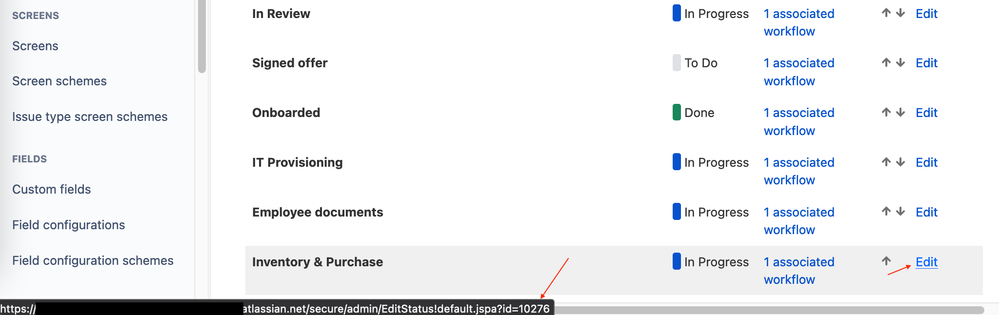

Go to Cog icon > Issues > Statuses.
Find the Inventory & Purchase status and hover the mouse over the “Edit”, so you can find the ID of the status:

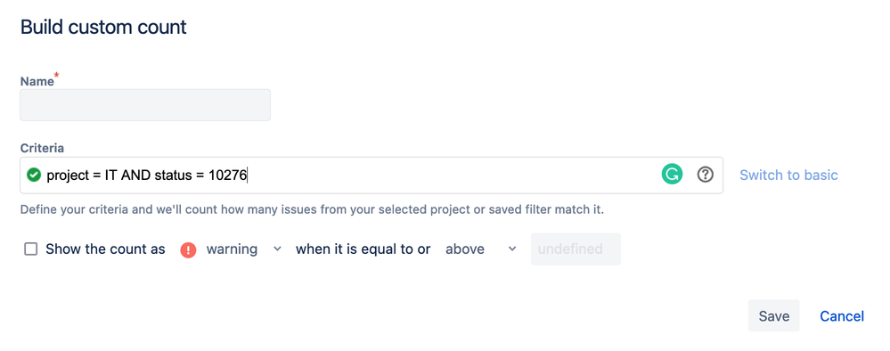

Then, go to the dashboard and on “Counts”, instead of selecting the status, select the “Build custom count” and the criteria will be “status = 12345” which is the ID.
